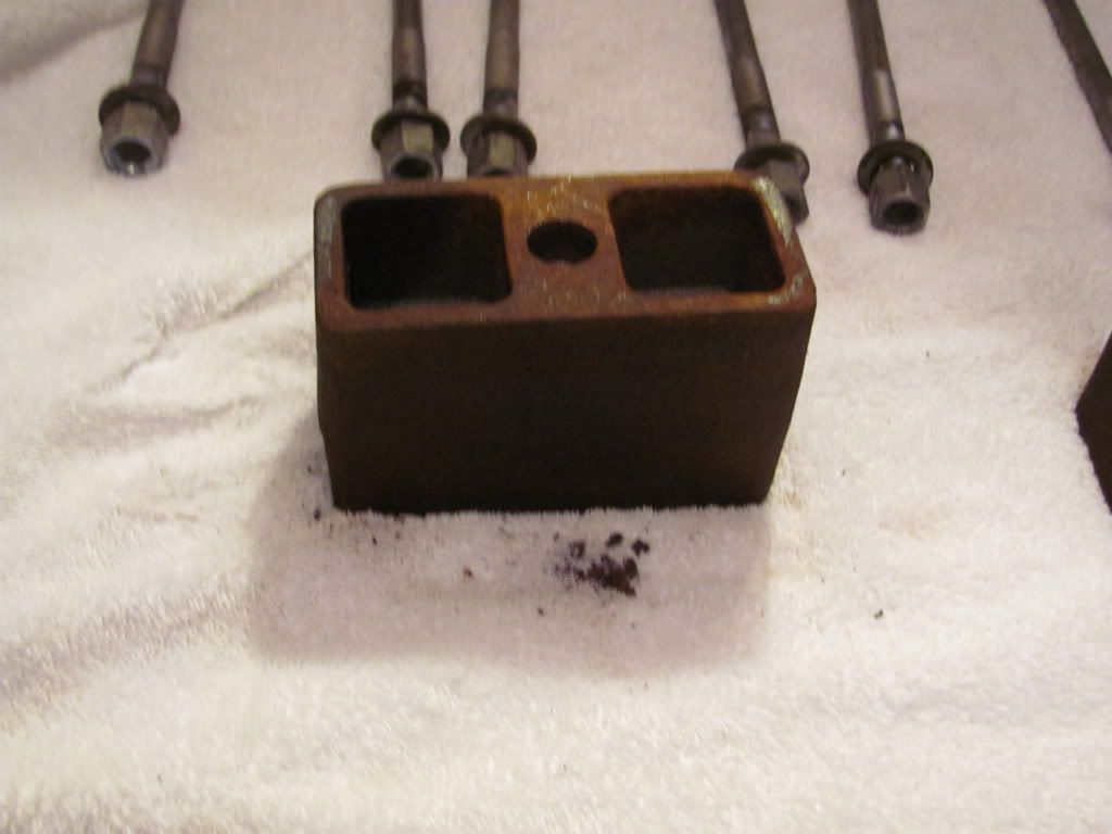

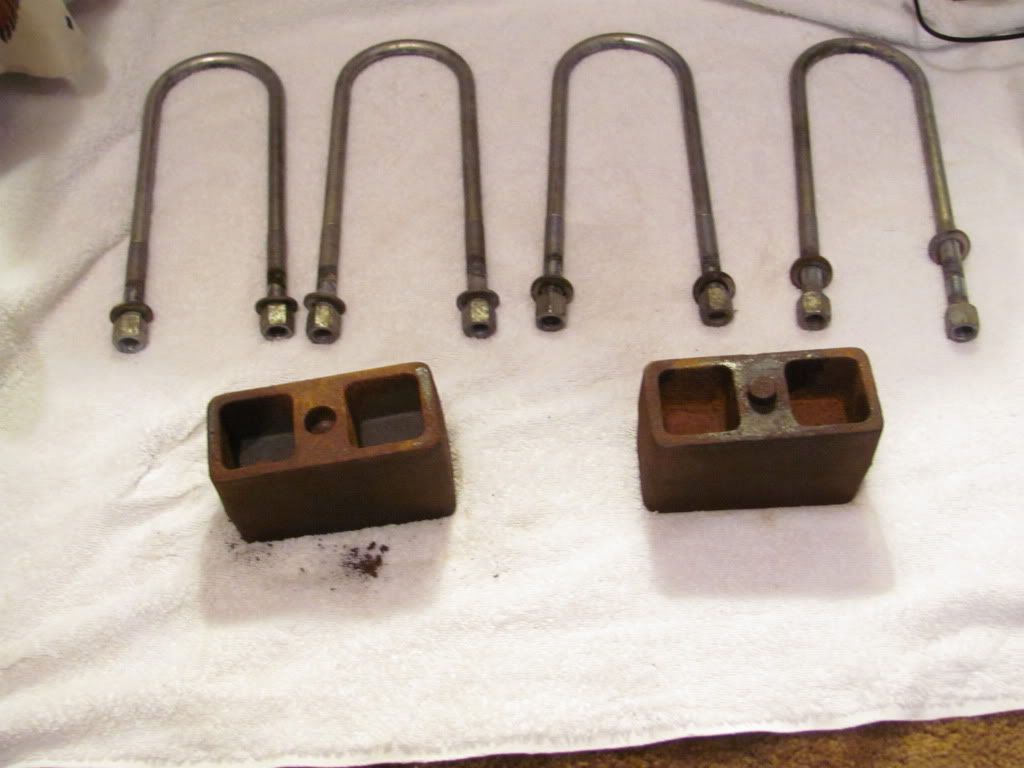

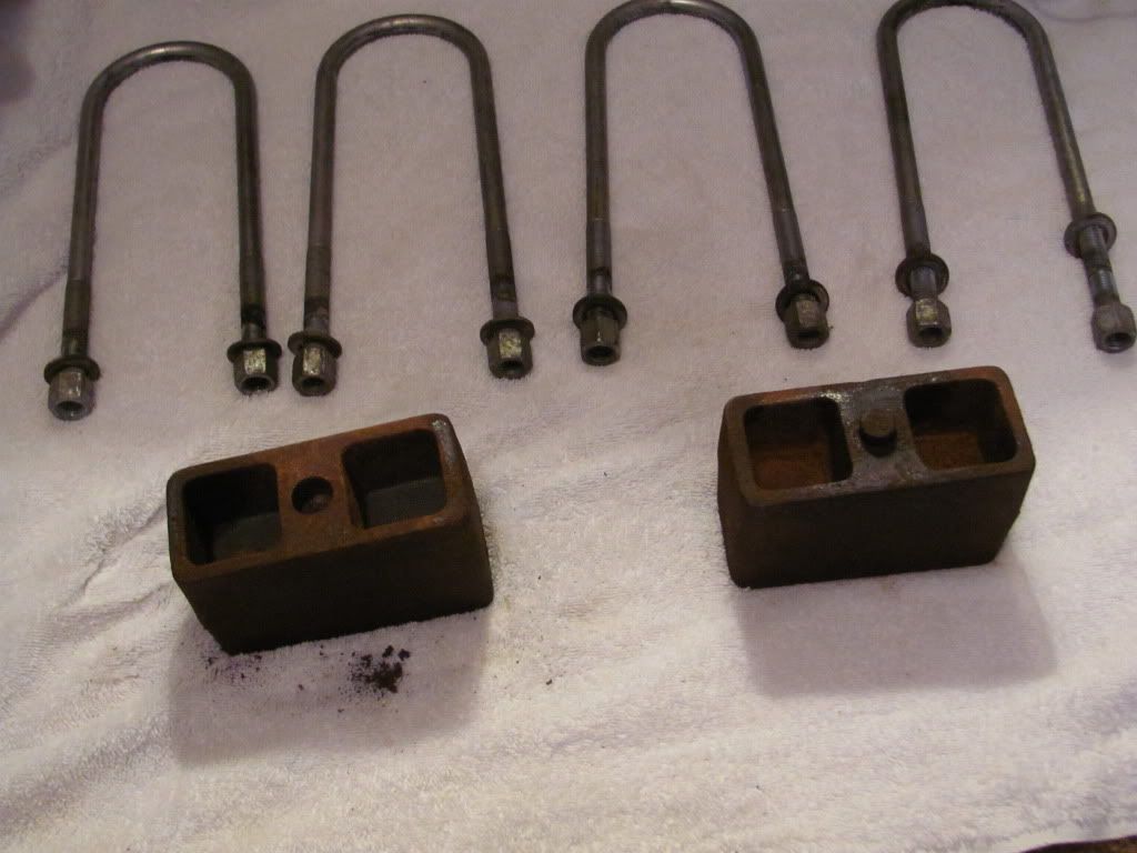

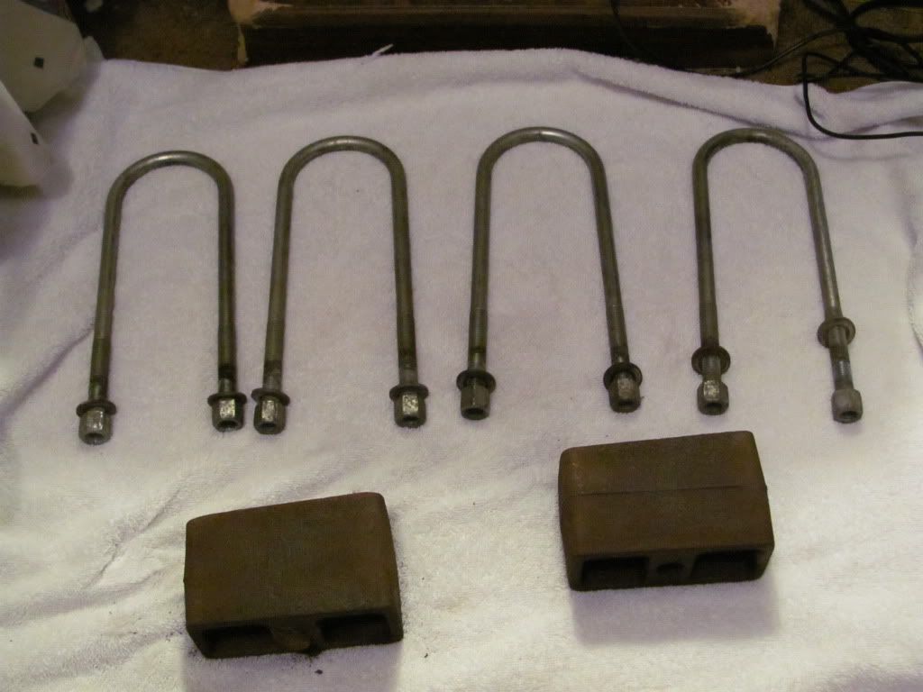

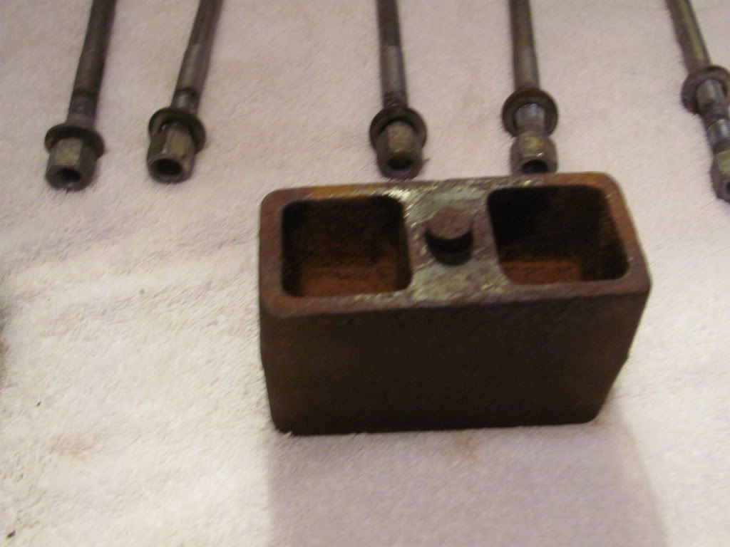

U bolts huh....well I have some U bolts from a lowering block kit I had for and truck of mine. I have some pictures of the lowering blocks actually and I am also wondering if the black itself is good enough steel to be forged into something. I wonder if the block is a tool steel, then it would be nice to try and forge a hammer head out of one. Or send it to someone who could. How do I go about finding out what kind of steel the u bolts and the block is? Can you tell from just looking at it? I doubt it and I know that might be a dumb question, I just had to ask.
Posted Image
Posted Image
Posted Image
Posted Image
Posted Image
The u bolts dont have those screws attached to them I just have them screwed on with a washer. The pictures were actually for craigslist when I was trying to sell them. ( no luck though) :( So I hope to get some use out of them at the forge!

You can spark test it and do a quench test. About all that would do is tell if it's alloy or mild. But if it has a feathery spark then it would be great for a hammer at least.

The blocks look cast, if they are, they will still throw a good spark but you won't be able to forge them.
