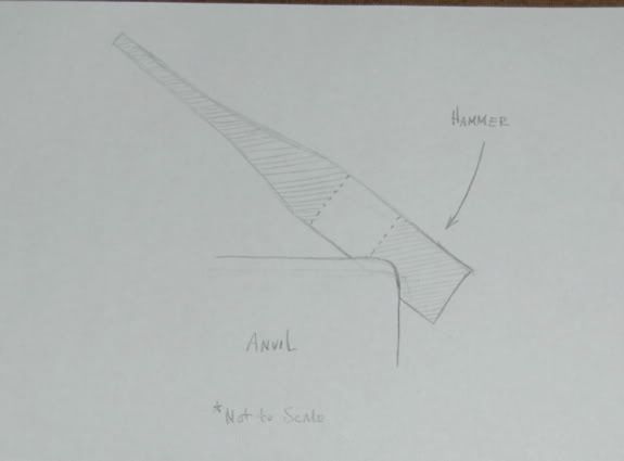

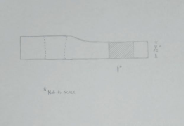

Also, I am sorry for the poor picture quality. They are pictures of the drawings. I hope to have scans soon ^_^

• Drift: 1 1/4” x 1/2” (See Figure 2)

Figure 1
Posted Image
Figure 2
Posted Image
Step 1: Punching the Eye
• Begin with a section of mild steel or wrought iron stock. If you have a piece that you can hold with out tongs it will make the beginning steps easier.
• Heat the end of the bar up to a bright yellow; if you’re using wrought iron, the surface of the metal should appear very wet.
• Holding the punch with the 1/2” flat-jawed tongs set it about 1” from the end of the bar and as near to the centerline of the bar as you can get it. Have your striker use a light blow then check the placement of the punch mark. Now is the time to adjust it if you need to. (See Figure 3)
• Once you are satisfied with the placement of the mark, drive the punch into the stock. Be careful not to let the tip of the tool get too hot and deform. It is easiest not to work below a low orange heat. Drive the punch into the stock until you feel the resistance of the anvil. When you feel that, remove the punch and turn the bar over onto the other side. It should be fairly easy to find where the hole is on the other side as it is in the center of the bulge. It should not take more than a few light blows to remove the biscuit (the small chunk of material that is punched out). (See Figure 4)
*Note: Punching the eye may take several heats, do not expect to get it all done at once.

Step 4: Forming the Eye
• Heat the eye to a near welding heat. Drive the punch into the slot that was made earlier, but be careful not to drive too hard. Hammer the sides of the eye in order to make the hole bigger. (See Figure 8)
• Once you are able to drive the punch all the way through, use the 1/4” flat jaw tongs to grip the blade, heating the pole. Set the far side of the eye on the far edge of the anvil, creating a shoulder 1/4” – 5/16” from the edge of the eye. Thin the area at the corner of the shoulder to about 1/2” thick. (See Figure 9)
• Getting the pole as hot as you can, thread the 1/2” bar through the eye and set it across the jaws of a vise. Use the riveting hammer to upset the pole (See Figure 10). The pole will want to turn down towards the eye, so it is important to keep it strait. One thing you might do is use the peen to spread the material as well as push it back onto itself. Make sure not to let the pole get any wider than the eye. This is the step where it will happen so make sure to prevent it as soon as it starts to make things easier on your self.
*Note: it is not important to get the exact shape of the pole during the forging process.
• Once the pole has been shaped, it is safe to do the final drifting of the eye. The adze should be held by the blade during this step. Tap the drift into place so that it fits snugly. If the hardie hole is big enough, place the eye over it and tapping the drift in. If you do not have a hardie hole of the proper size, a plate with a round hole that is large enough for the drift to fit through can be used over the jaws of the vise. DO NOT drive the drift all the way in! This is important, as it will cause the wrought iron to tear and ruin your hard work. Once the drift is snug, lay the eye flat on the anvil and hammer the walls thinner (Refer to Figure 8). This makes the diameter of the eye larger and makes the walls thinner and closer to the final size.
• Set the forward end of the eye over the thickest part of the anvil’s horn. This acts like a large fuller and helps to make a smooth transition from the eye to the blade (See Figure 11). For this step, you may choose to hold the adze by the pole. In which case you will want to use the large box-jaw tongs.
• Once the eye has been drifted to the proper size, use the riveting hammer to shape the lugs. Bring the hammer in at an angle to hit on either end of the eye, leaving the center ridge untouched (See Figure 12). By doing this you should be able to create the points that extend down. Use the drift as an intermediate anvil to keep the lugs from getting thicker than the rest of the eye.
