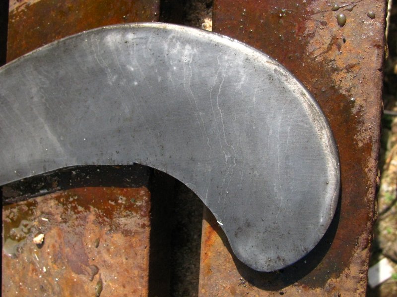

  1. Nice work, I've been trying to get a similar result by using a pantograph engraver to mill through the outer layer of a billet of plain 1080 laminated with pattern welded scales. The pattern does distort when the engraved billet is hammered flat but I will be able to reduce distortion by using a rolling mill. I can compensate for the linear distortion of the rolling mill by adjusting the pantograph.
  2. You need to finish this blade so that you can compare it to your later efforts. It will serve as a useful marker in your quest to perfect this pattern. I like it so much that I may fire up the forge this weekend and try some jellyroll patterns that have been floating about in my mind.

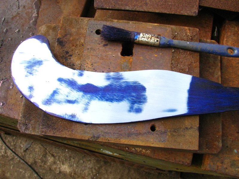

  3. Grind off the scale...
    ...add some layout fluid (enjoy the smell)...
    ...and after a quick burst on the platten...
    ...and repeat...
    ...then do t'other side...
    ...a quick etch...
    ...the flip side...
    Then after a sucessful HT in oil...
    ...obverse side...
    Success.
  4. After coffee and cake I cut the billet in half then cut one of the halfs into 3 pieces. These 3 pieces were welded back together but welded side to side, not face to face.
    The other half plus this 'side by side' billet were used to laminate a piece of CS80; you know the score - heat, flux, big hammer etc.
    The billet was ready for shaping into a billhook...

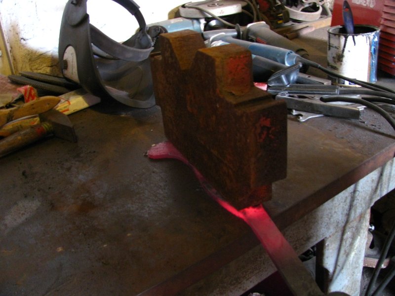

    ...and after a normalising cycle or two, get the whole thing hot...
    ...and straighten on the bench using a big lump of steel.

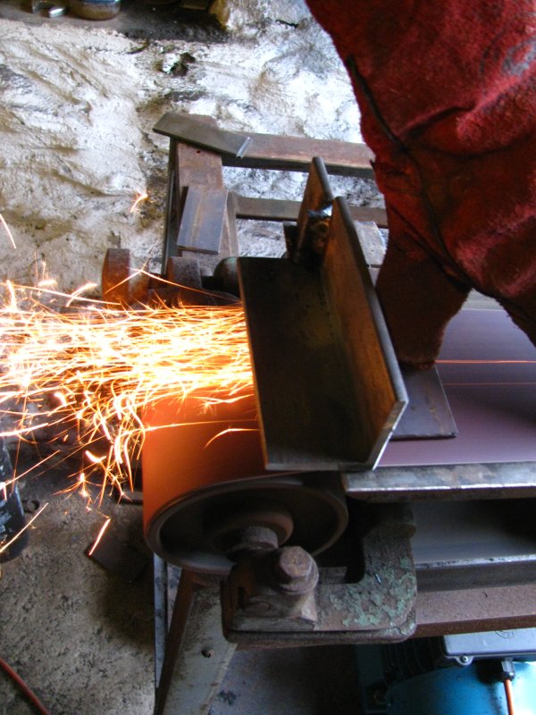

    First I added a new 3HP motor to an old, small 100mm x 915mm (4" x 36") linisher.
    The platten was worn...
    ...so under the grinder it went...
    ...and soon all was well.
