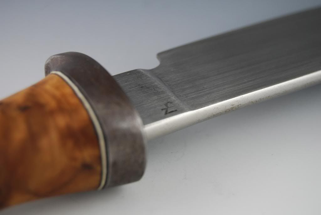

  1. One downside to College is being cut off from my shop, so I've been trying to make the most of my brief summer. I finally got back into the swing of things after a couple rough test pieces to give my muscles a chance to regain their memory. I'm really pleased with how this came together, it went surprisingly smooth the whole way along.
    The blade is 5160. The handle is thuya burl with wrought iron fittings.
    6.5" blade
    4.75" handle
    11.25" OAL
    Thanks to you all for looking!
