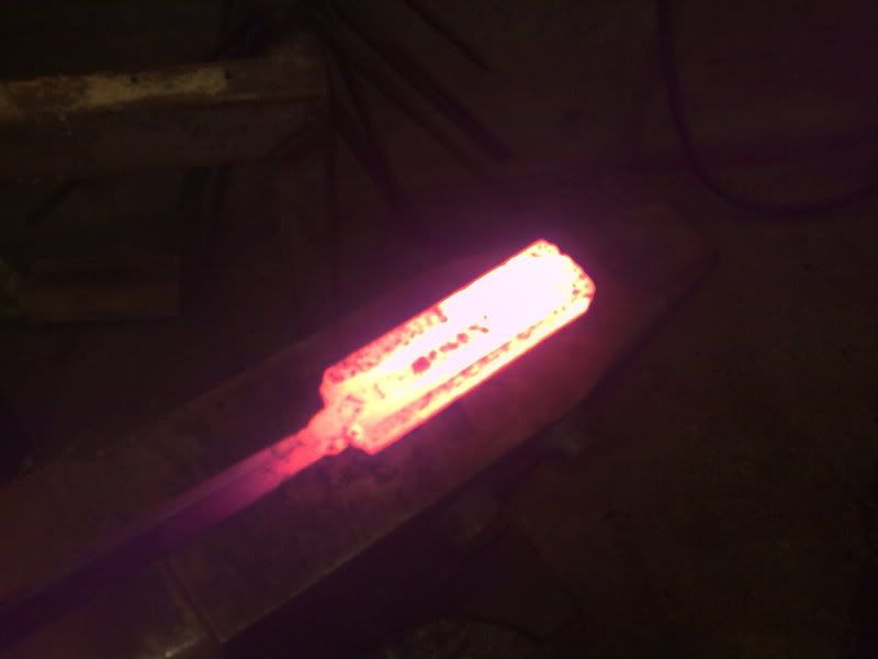

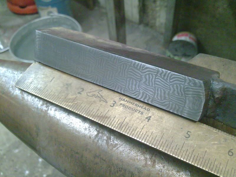

TOBY Posted October 6, 2008 Share Posted October 6, 2008 (edited) Having been bitten by the folder bug, and inspired by Mr Fisk's "Old thorny" folder (No# 4 of his 2007 pieces) http://www.fisk-knives.com/MICRO_INVITATIONAL_SHOW.html So i thought i would have a go at making something similar, first off the steel.... not a complicated pattern (but i did have to scratch my head once or twice before i started ) and this is how i did it first off start off with 13 layers of steel, 20c and 15n20, i doubled up on the 15n20 to get and even thickness in the layers this was then welded up and drawn out into one bar 15mm (or) 1/2" square. and then cut up into eight pieces and restacked now tack welded and ready for welding billet welded up ready for drawing out (note - be sure to keep dimentions similar to avoid making the "squares" of the weave dissimilar) billet drawn out to 14" and cut up into 7 pieces ready for a restack all stacked up and ready for welding welded up - next cut off handle and weld to end so the billet can be trued up and made neat and tidy all trued up and given a quick grind and etch to see if we have messed up:rolleyes: now i just have to take a slice off and see if i can make it into something sharp thanks for looking - i will post update when i get a chance to make it into a knife;) Edited October 6, 2008 by TOBY Regards TOBY Link to comment Share on other sites More sharing options...

Arthur Posted December 19, 2008 Share Posted December 19, 2008 Your basket weave is beautiful !!!!! but I keep looking at the pictures and I can't figure out how you exposed the pattern without accordianin cutting..I know it's somewhere in the restacking, but you lost me....I'd really appreciate it if you can explain a little more....Thanks "Twenty years from now you will be more disappointed by the things that you didn't do than by the ones you did do. So throw off the bowlines. Sail away from the safe harbor. Catch the trade winds in your sails. Explore. Dream. Discover." — Mark Twain Link to comment Share on other sites More sharing options...

TOBY Posted December 20, 2008 Author Share Posted December 20, 2008 Your basket weave is beautiful !!!!! but I keep looking at the pictures and I can't figure out how you exposed the pattern without accordianin cutting..I know it's somewhere in the restacking, but you lost me....I'd really appreciate it if you can explain a little more....Thanks Thanks Arthur, and if you imagine a finished billet ready to be accordian cut - then cut it up into small tablets, turn these through 90deg and carefully weld together - you now have the face end of the previous billet showing multiple times down the length of your newley welded billet, hope this helps, easy to show in person but not so easy to explane with words Great job. What power hammer is that you have? Its a 40kg Massey Anyang Regards TOBY Link to comment Share on other sites More sharing options...
