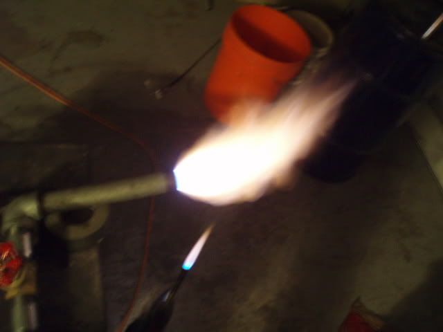

Doug Lester Posted November 18, 2008 Share Posted November 18, 2008 I, of course, haven't seen Mr Blue's rig but I'd recommend a needle valve on the gas line (note: this does not replace the shut-off valve) for fine adjustments. I have to open my valve a little when the forge is cold and then cut it down a bit when it gets up to full temp. I haven't done any measurements as to how many hours of burning that I get out of my forge with the blown burner but I do believe the it uses the gas at a lower rate. Doug Lester HELP...I'm a twenty year old trapped in the body of an old man!!! Link to comment Share on other sites More sharing options...

Doug Lester Posted November 19, 2008 Share Posted November 19, 2008 (edited) You're going to need a blower that will deliver at least 60cfm. If you go above that, you can adjust it with the gate or ball valve on the line behind the inlet for the gas. If you can't find a needle valve locally, try elliscustomknifeworks.com. Darrel has saved several of us by stocking some of the harder to find parts. Doug Lester Edited November 19, 2008 by Doug Lester HELP...I'm a twenty year old trapped in the body of an old man!!! Link to comment Share on other sites More sharing options...
KPeacock Posted November 19, 2008 Author Share Posted November 19, 2008 (edited) Without the needle valve, I was able to produce and maintain a flame and vary it's coloration a little bit. There MAY be pics of this if I can figure out how to post them. If they don't show up, I'm sorry. This was produced at about 5psi running through a 1/8" inlet hole. I decided to try it with a hairdryer as the blower. I had my doubt regarding the flow rate of the dryer, but this was all done on the lowest setting and seemed to be enough. I had the gate valve on the air supply mostly closed. This is built to duplicate a forced air burner I saw online a Indian georges knives. The only difference with his and mine is the fact that Mine has a 12" mixing tube where his is 6." I can't imagine this would change performance much. This is a picture of the flame itself... Here is the layout... Here are the bits and pieces that will become the forge... Edited November 19, 2008 by KPeacock Have you ever thought about the life of steel? It's interesting to think that you can control the fate of a piece of metal. Link to comment Share on other sites More sharing options...
