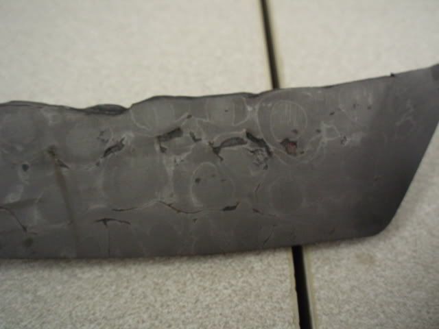

KPeacock Posted December 1, 2008 Share Posted December 1, 2008 I've got my propane forge up and running and i am having a problem with my propane tank. there is some sort of a safety feature present that causes the pressure to drop to nearly zero anytime the flowrate exceeds some trip limit. I have my tank hooked to a hose that is then plumbed through a regulator, a pressure guage, an emergency shutoff globe valve, and then a 1/4" needle valve before endering my forced blower orifice. Is there a way for me to keep the tank from shutting down? this is NOT the result of freezing up the tank, this is something entirely different. Thanks for your input and help. PS, the forge does get up to welding temperature. To test it, I made a half hearted attempt at chain damascus using chainsaw chain. I did not work the metal much. I simply hammered it flat and then hit it with the grinder to rough out the shape. you can very clearly see areas that did NOT weld well, but overall, it worked out better than I thought for my first attempt at it. It's got a pretty rugged look to it, thats for sure. I'll likely do some more filing and refine it a bit and then see about making a handle out of delran. Have you ever thought about the life of steel? It's interesting to think that you can control the fate of a piece of metal. Link to comment Share on other sites More sharing options...
