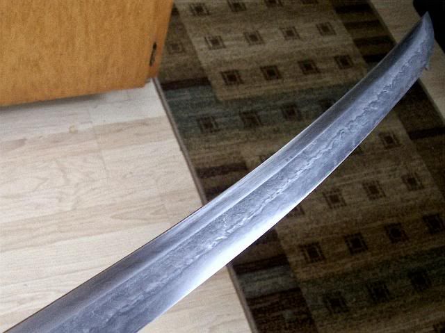

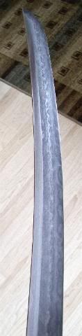

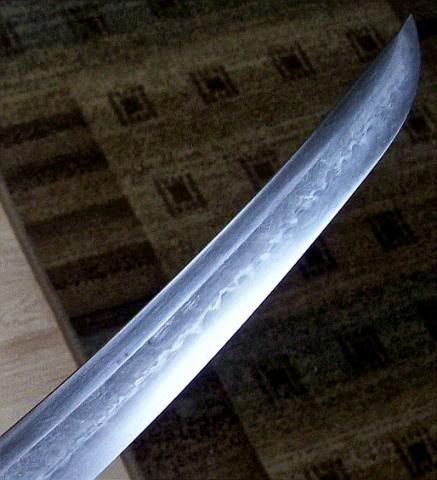

neil gagnon Posted December 31, 2008 Share Posted December 31, 2008 here is a cable katana I made last year and finally had time to finish.The blade is 29 inches long and is marquenched with water brine. The handle is 12 inches long and is made of ash with a full ray skin wrap with brass fittings and my own wrap i've been working on.Tsuba is made of steel my own design. The saya is made of poplar with steel fittings on both ends. It is a beefy blade and razor sharp hope you like. "One who is samurai must before all things" Keep constantly in mind, by day and by night. the fact that he has to die... -Dai Doji Yuzon- 16th Century http://sites.google.com/site/canadianliveblade/home Link to comment Share on other sites More sharing options...
Ben Potter Posted December 31, 2008 Share Posted December 31, 2008 Beautiful work, Love the hamon. Ben Potter Bladesmith It's not that I would trade my lot Or any other man's, Nor that I will be ashamed Of my work torn hands- For I have chosen the path I tread Knowing it would be steep, And I will take the joys thereof And the consequences reap. Link to comment Share on other sites More sharing options...
Michael Pyron Posted December 31, 2008 Share Posted December 31, 2008 Yes, veeeery beautiful hamon. Link to comment Share on other sites More sharing options...

C.Anderson Posted January 1, 2009 Share Posted January 1, 2009 Wow! Love that hamon...and the profile of the blade is very nice. The whole thing just looks aggressive =). Two questions though.... First, how do you marquench into water/brine? I thought marquenching was quenching the blade in to a medium that is just above martensite start? Just looking to learn something =). Second...do you have a link to higher resolution images? That blade's stunning =). Cris Slow is smooth, smooth is steady, steady is fast, fast is deadly... Erik R. http://www.facebook.com/scorpionforge Link to comment Share on other sites More sharing options...
neil gagnon Posted January 1, 2009 Author Share Posted January 1, 2009 I also used oil in quenching that blade,Thanx for pointing that out sorry about the pics,I'll see what i can do about some more pics,my camera is missing in action from party last night. "One who is samurai must before all things" Keep constantly in mind, by day and by night. the fact that he has to die... -Dai Doji Yuzon- 16th Century http://sites.google.com/site/canadianliveblade/home Link to comment Share on other sites More sharing options...

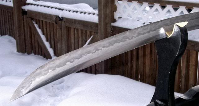

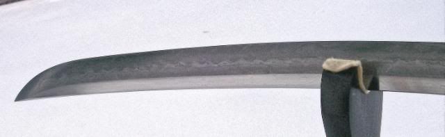

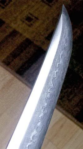

neil gagnon Posted January 2, 2009 Author Share Posted January 2, 2009 here are some close ups of steel. "One who is samurai must before all things" Keep constantly in mind, by day and by night. the fact that he has to die... -Dai Doji Yuzon- 16th Century http://sites.google.com/site/canadianliveblade/home Link to comment Share on other sites More sharing options...
james G. Posted January 2, 2009 Share Posted January 2, 2009 That a great looking sword the cable is a nice touch. Link to comment Share on other sites More sharing options...
