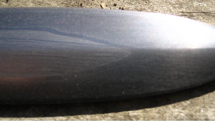

JPH Posted March 2, 2009 Share Posted March 2, 2009 (edited) Mr. Pringle: That looks MUCH better than the first photo..To me it doesn't LOOK like a fold over at the present time..Looks rather solid in fact. Guess I don't have to tell ya about my hot biscuit technique ....It does make things a bit easier on the hairpin welds... Question.. Have you tried welding the edging to the two outter cores, then welding the two edges/outter cores together with the centre core in between the two p[reviously welded core sides?? I have done that a few times and it presents an entirely different set of patterning problems.... I am working on a shortsword thingy I welded up out of some old files I had laying about (shouldn't waste decent steel) and some 300 series SS I did on a whim just because I had nothing better to do that day.... below is a photo of it before I fuller it... Fullering can play with your head as well when it comes to patterns too..(that should come up shortly if this discussion heads where I am thinking it is.....) Not the greatest photo in the world but I never said I was a photographer. This is as forged and before fullering...the SS is really thin as I used HT foil I took in on a trade a while back...A little "tricky" to weld, but boy is the contrast NICE....Right now it's a bit on the "rough side" pattern wise but it will all "smooth out" once I get done with it... Mr. Longmire: Thank you Sir for the kind words..my beard is long gone thanks to all those years in the Nevada Guard, although for a while there I was rather wild and woolley...between stints working for Uncle Sugar.....Now that I am retired..My wife likes the "mr Clean" look...I think she is use to it actually.... Now I do have to ask ..Who let J. Arthur in here??? Then again, you all let me in and now ya all see what you get???.. How you doing on your side of the country Arthur?? I am strongly leaning towards cores closer to finished length that what most of us have believed and seem to have used before, and since others are independantly finding the same basic things that I am, this verifies that we are on the right road, at least for now. This is a good thing indeed...Maybe one day will will be able to figure it out..only to find some other blade done differently and that would be fun too....Something "new" always come up... Now I just have to get out of the Japanese section of book IV and get into the down and dirty of the European section as well.... JPH I am sorry..this photo just didn't work out as expected...Maybe I should load up my Gatling Gun and threaten my computer one more time to get it to do what I want....It really bites being a 19th Century man stuck in the 21st.... Edited March 3, 2009 by JPH If you wish to know the price of freedom..Visit a Veteran's Hospital...I am humbled by their sacrifice... Why is it when the Mighty Thor throws his hammer he is dispensing Justice and fighting Evil..BUT..when I throw my hammer I wind up in a mandatory 16 week anger management course??</p> I came into this world naked, screaming and covered in someone else's blood...I have no problem going out the same way... Link to comment Share on other sites More sharing options...
Jeff Pringle Posted March 3, 2009 Share Posted March 3, 2009 Hey Jol – that’s the way to do it! That sax is continental Merovingian, I would guess from its form, in a private collection so less officially placed than a museum artifact. I have not tried welding the core to the edge first, but in consideration of the stretch issue have been thinking about how complicated you can get with the core and still do everything in one weld operation. This current blade was done in one shot. It would get dicey with a six- or eight-bar core, I bet! Here’s a small section of twist, split in two and welded side-by-side then ground down a wee bit – note the complete lack of bookmatching going on... Jomsvikingar Raða Ja! http://vikingswordsmith.com Link to comment Share on other sites More sharing options...

JPH Posted March 3, 2009 Share Posted March 3, 2009 (edited) Mr. Pringle: On the photo of the split..did you totally seperate the pieces and then weld them edge to edge or did you cut/chisel though 3/4s of the way, lay that open and then weld the "folded sides" together? I have been playing with the latter on some test pieces and I do get a matched pattern..as long as I am very careful about the depth of the cut...I feel that is the key to making this work on the "opening book" cutting technique. I do "square" the bars prior to this...makes the chisel slitting much easier, still takes some time ..I work alone, at first it took forever, now with my fly press that speeds things up a whole lot... Just curious...Speaking of fly presses, that makes fullering very quick... JPH P/S: When I get my next buggered up core I will do the open book slit and get a photo and post it...most times a photo really helps.. Right now I am working to get as much done as I can as I have a 7 weekend stint at RPFS coming up that starts the first weekend of next month...so this may take somr time.. Edited March 3, 2009 by JPH If you wish to know the price of freedom..Visit a Veteran's Hospital...I am humbled by their sacrifice... Why is it when the Mighty Thor throws his hammer he is dispensing Justice and fighting Evil..BUT..when I throw my hammer I wind up in a mandatory 16 week anger management course??</p> I came into this world naked, screaming and covered in someone else's blood...I have no problem going out the same way... Link to comment Share on other sites More sharing options...
Jeff Pringle Posted March 4, 2009 Share Posted March 4, 2009 That is an awesome blade, Alan! When do we get to see the matching spade, or a P-W’d EDC trowel for yourself? On that split twist it was completely cut, and indeed you get a well-matched pattern when you split a twist, with chisel or saw – but the bars will not book-match, since the split pair (even if Siamese, I believe) will both be either right or left handed as the parent twist was. This spear illustration was included in an article by Ypey to show a pattern so exactly matched it must (in his eyes) have been a split bar, and is probably what most folk imagine they will see when they open a twist. Sounds reasonable, but you can’t get the pattern that way! It is a cop-out theory that robs that smith of most of his glory – he really did make sure his left and right bars matched EXACTLY, and not only that he made sure they were revealed to the same cross-section in the finished spear – this guy’s beard was on fire! Best of luck at the RPFS, I hope the economic doomsayers don’t dampen the spirits there this year! Jomsvikingar Raða Ja! http://vikingswordsmith.com Link to comment Share on other sites More sharing options...

Jeff Pringle Posted March 5, 2009 Share Posted March 5, 2009 How many heats would you guys expect at welding temp to create a sword sized blade? four to six in one pass, followed perhaps by three or four “insurance” welding heats on a second pass…more or less, depending, etc. Here’s a short video of the tip weld on this serpent blade, not very smooth (although considering how out of practice I am, not bad, either! ), but it got the job done: …at some point in the middle of hammering I discovered an unnoticed hole in one glove - so it wasn’t just the beard burning during this weld! Jól, I like it! You have obviously twisted two bars in the same direction, to an incredible exact match, then carefully forged and ground them together so as to reveal the precise same layer all along their length, to trick people into thinking you had just twisted up a bar and bandsawn it in two – brilliant! Jomsvikingar Raða Ja! http://vikingswordsmith.com Link to comment Share on other sites More sharing options...
