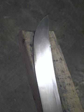

Well here is what i have been up to lately, This is a big sword i am making for myself, kind of a challenge. The overall sword is 48.25 inches long with a 36 inch blade. The cutting edge goes from 1.25inches tapers up to 1.75 inches then tapers back down to the point. Right now I just started polishing at 80 grit. Probably will be awhile on this project. I am thinking of maybe a 15 inch handle on this one. The hamon and steel should be exact to the kitchen knife I did awhile back. Almost forgot it has about 1.50 inch of sori. Will post more pics when done. I have a couple of other projects on the go also with cable & w2 that I am working on.

Looks like one heck of a cutter. nice.

thanks guys it should be a good cutter. I am sure i have a few tatami mats lying around looking for some punishment.

I guess it does have a dha look to it, maybe i should skip the tsuba.

yep, at least mine always do that is 80 grit.

I had no idea the hamon showed up that early in the polish!
the hamon will show whenever all or most of your scratches are running the same way. generally i check my hamon on a 36x belt straight out of the quench.
cool sword, neil.
Thank-you Jake your Rune Seax is a very nice piece.
