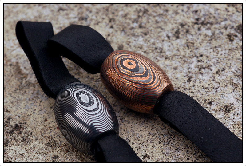

Ariel Salaverria Posted August 15, 2009 Share Posted August 15, 2009 Not much to show this week as I'm finishing up some knives for previous orders. First we have an etched blade for a Slim Criollo Knife. Then a Nessmuk Bare Blade that a customer asked me to rush. On the this blades, I etch my mark on the other side, so when you see a Nessmuk with AES on the right side, it's an entire knife I've made. When you see one with the AES mark on the left, I just made the blade. More pictures here: http://www.aescustomknives.com/docs/pro_nessmuk3.htm And then, some beads: More pictures here: http://www.aescustomknives.com/docs/gallerybeads.htm My website: http://www.aescustomknives.com/ Sign up for my Newsletter: http://yourwebapps.com/WebApps/mail-list-s....cgi?list=79955 Thanks for looking! Ariel Ariel Salaverria Link to comment Share on other sites More sharing options...

Ariel Salaverria Posted August 21, 2009 Author Share Posted August 21, 2009 No real secret here, use two steels with at least .6 carbon difference, mirror polish and then use new ferric perclorure to etch. You'll get the same results Ariel Ariel Salaverria Link to comment Share on other sites More sharing options...
