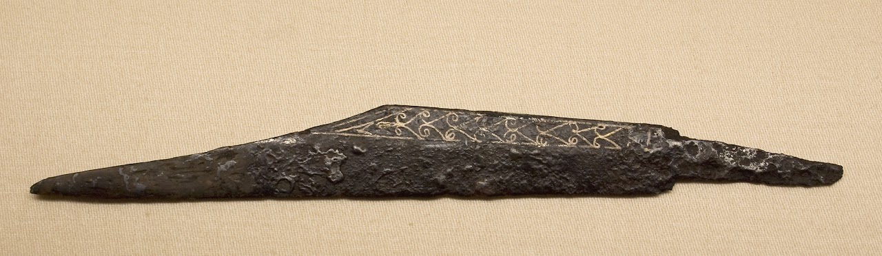

dustin reagan Posted August 17, 2010 Share Posted August 17, 2010 I'm looking for any info on this seax. I've been told that it has a blade length of only 12cm. Does anyone have any other info, and/or pictures (especially of the spine)? Thanks, Dustin Link to comment Share on other sites More sharing options...
peter johnsson Posted August 18, 2010 Share Posted August 18, 2010 I thought I had some pictures of this one. It is in the British Museum, but I seems to have ignored it each time I´ve visited so far. Stupid. It is a small knife. 12 cm sounds like it could be total length rather than blade length, but I may well be wrong: it could be blade length. I do rember that it made an impression on me from being very small and crisp looking, but quite sturdy in cross section. From memory I´d say it is some 6 or 7 millimeter thick in the back. The upper part of the face of the knife has a very shallow fuller. It is not a flat bevel, but very slightly radiused, where the silver is inlayed. I hope some one else have more reliable information. Link to comment Share on other sites More sharing options...
Jeroen Zuiderwijk Posted August 18, 2010 Share Posted August 18, 2010 This one is from the Klingesmuseum in Solingen. (I took the photo the same day I met you there Peter ). The measurement is of the blade, and only an estimate from looking ar it. So it can be a bit smaller or larger. There should be a second picture in my museum photo collection (see link signature) Jeroen Zuiderwijk Facebook page: https://www.facebook.com/barbarianmetalworking Link to comment Share on other sites More sharing options...

dustin reagan Posted August 18, 2010 Author Share Posted August 18, 2010 This one is from the Klingesmuseum in Solingen. (I took the photo the same day I met you there Peter ). The measurement is of the blade, and only an estimate from looking ar it. So it can be a bit smaller or larger. There should be a second picture in my museum photo collection (see link signature) Thank you for the info, Peter & Jeroen. Jeroen, forgive me, but I can only find the single photo in your collection. I'm looking here: http://1501bc.com/page/solingen/index.html I am going to attempt a rough reproduction of this Seax. Was there anything from this Seax that gave any clue as to its construction? I am going to forge-weld a simple wrought iron body to a strip of butt-welded edge steel. Is this a plausible method of construction? Thanks, Dustin Link to comment Share on other sites More sharing options...
Jeroen Zuiderwijk Posted August 18, 2010 Share Posted August 18, 2010 Thank you for the info, Peter & Jeroen. Jeroen, forgive me, but I can only find the single photo in your collection. I'm looking here: http://1501bc.com/page/solingen/index.html Yep, you're right, I only took one of that sax (I took two of the other small knives next to it). I am going to attempt a rough reproduction of this Seax. Was there anything from this Seax that gave any clue as to its construction? Not that I can remember seeing. I now only have that photo for reference. I am going to forge-weld a simple wrought iron body to a strip of butt-welded edge steel. Is this a plausible method of construction? Yep, that's one of the possible methods. N.b. one thing I've learned is that on saxes with inlays, the two sides usually are different. Now this is not going to help, as you don't have a photo of the other side, but it's good to at least know beforehand that you will have to make something different, rather then finding out afterwards! Jeroen Zuiderwijk Facebook page: https://www.facebook.com/barbarianmetalworking Link to comment Share on other sites More sharing options...
dustin reagan Posted September 9, 2010 Author Share Posted September 9, 2010 (edited) Well, a fellow myArmoury forumite (who speaks German), sent a request to the museum for more pictures of this blade. Here's a small picture of the opposite side! Jeroen, you were correct, the blade does have a different pattern on each side. This picture also gives a better sense of the blade shape...it's quite interesting and now I wish I had tried to replicate this blade shape as well, instead of more of a "honey-lane" shape. Next time! I wonder if this seax may have had a deeper belly that got "used up" over multiple honings? Dustin Edit: replaced linked image with higher resolution version. Edited September 9, 2010 by dustin reagan Link to comment Share on other sites More sharing options...

GEzell Posted September 12, 2010 Share Posted September 12, 2010 Well, a fellow myArmoury forumite (who speaks German), sent a request to the museum for more pictures of this blade. Here's a small picture of the opposite side! Jeroen, you were correct, the blade does have a different pattern on each side. This picture also gives a better sense of the blade shape...it's quite interesting and now I wish I had tried to replicate this blade shape as well, instead of more of a "honey-lane" shape. Next time! I wonder if this seax may have had a deeper belly that got "used up" over multiple honings? Dustin Edit: replaced linked image with higher resolution version. Wow, thank you for posting this! Very interesting how the two sides relate stylistically to one another. Almost no edge curve to this one, either...almost but not quite straight. I have tentative plans to make a sax based on this one myself, if my inlaying ability improves. George Ezell, bladesmith" How much useful knowledge is lost by the scattered forms in which it is ushered to the world! How many solitary students spend half their lives in making discoveries which had been perfected a century before their time, for want of a condensed exhibition of what is known."Buffonview some of my work RelicForge on facebook Link to comment Share on other sites More sharing options...
