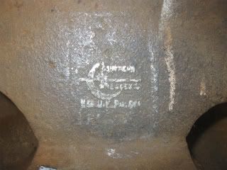

Robert H. Posted March 3, 2011 Share Posted March 3, 2011 Hey Guys, I'm new to this forum (and smithing in general). I have searched high and low trying to find makers marks for anvils, with no results other than to buy a book on anvils (I'm not that involved yet). I have an anvil that I bought at an auction several years ago. It's in pretty rough shape IMO, but I have it, so might as well use it for more than straightening bent objects. As far as ID goes, all I can see on the side, is what looks like a cresent moon. All the other writting (which there is quite a bit) is not clear enough to read. The only other marking is the number 8 cast into the base, near the foot on the horn end. If needed, I will try to get a pic of the markings, but I doubt they will show well in a pic. The anvil is probably around 75 lbs or so (thats a guess). If any of the anvil experts out there have a clue as to who made this one, I'd appreciate hearing from them. Thanks, Bob Link to comment Share on other sites More sharing options...
Alan Longmire Posted March 3, 2011 Share Posted March 3, 2011 Can you get a picture of it? I have that anvil book and will help as best I can. As far as I know at the moment (I'm at work and the book is at home) the only cast anvil to use a crescent moon is the Southern Crescent. From what I remember they were made in Chattanooga, TN, I don't remember the dates. They are similar in quality to the Vulcan, being a cast iron anvil with a steel face. Of those, Fishers are by far the best, but many an object has been forged on a Vulcan (and a Crescent!). They tend to be a bit chippy on the edges, since the face is fairly thin compared to Fishers. The 8 is most likely the weight x 10, or 80 pounds. One way to bring out the writing is to rub it with chalk. You can also try to do a rubbing with a pencil on a piece or paper held on the anvil. Link to comment Share on other sites More sharing options...
Robert H. Posted March 3, 2011 Author Share Posted March 3, 2011 Alan, thanks for the quick reply! I tried the chalk, rubbing, etc... The only (fairly) clear thing that I can make out is the crescent moon, it's fairly clear but any text or numbers are far too blury to make out. As you said, it appears to be cast due to the numerous sand holes in the body (not the best of castings) The steel face is in really rough shape, and it does have lots of chipped edges on the cast under the edges of the steel. Someone cut off a section of the steel plate (about 2" or so) just behind the flat top of the horn. On the other end, the corner of the steel is broken off. I would guess that the steel plate is starting to break loose of the casting. I'm going to use it just to try out some smith working to see if I would like it (my guess is I will). The only forging I have ever done was back in high school. I made a chisel in metal shop. I have a bandsaw mill, so I have lots of 1 1/4" x .045 steel to use for stuff, along with tons of other steel I have laying around. I thought of doing this years ago, but never got around to it (life's too short to do everything). I also have some kind of forge that has a hand cranked, gear and belt driven blower under it that I thought I could use to start with. I got that at a yard sale for $5. It was being used as a yard ornament and I believe it is some kind of rivet forge. I may take off the old blower and fit it with a motorized blower. I have always built most everything I need myself, welding it all together. There have been many times that I had to heat stock up with a torch to bend it, or put a flat on a piece of round stock but I never really thought about forging anything beyond that. I will get some pics ASAP, but I think you called this one right. I'm in South Carolina, not so far from Chattanooga. It's a good possibility that anvil made it's way here. Anyways, thanks again for the quick reply and info. Bob Link to comment Share on other sites More sharing options...
Robert H. Posted March 4, 2011 Author Share Posted March 4, 2011 OK Alan, I got a few pics of the rough old anvil. Here's a pic of the "makers mark". The markings are much clearer in the pics than viewing it by eye. A side view Top view. The shine on the top is just from running a flap disc sanding wheel across the top to see how bad it was. The hardy hole is 3/4 x 3/4 (if that means anything) End view with the #8 I hope this is what you needed. This is off the subject, but here's a few pics of that forge I was talking about. Do you think it can be used for anything? Those are a couple brazing rods laying across the top. They have nothing to do with the forge (at least I hope not!) I think I will put a power blower on it. I would like to keep it original, but the belt is high dollar and the bearings in the blower have been poured in lead (kind of sticky) and the crank gear shaft and bushing/bearing are kind of worn. I really don't want to get that involved in a restoration project. Thanks again for any advice. Bob Link to comment Share on other sites More sharing options...
Alan Longmire Posted March 4, 2011 Share Posted March 4, 2011 Yep, That's definitely a Southern Crescent! The top shows the damage usually associated with the lower tier of steel-faced cast anvils, but considering the only other Southern Crescent I've seen in the flesh had a 1/4" wide strip of steel left down the center with an inch or two of the cast chipped away on both edges, looking like a big hot cut instead of an anvil face, that one is in pretty good shape. Sorry I got kind of busy last night, and I didn't look it up in the Tome. I'll get to it sometime. As for the forge, I started out with a little rivet forge similar to that. Mine had a bracket to take a hand-crank blwer instead of the built-in ratchet blower like yours, that's cool. I hear you on the getting it to work part. Do keep the parts, there are folks who look for those gears, etc. and will pay for 'em. You will hear people telling you to line the pan with clay/concrete/adobe/ whatever, but I'm telling you not to do it. That forge was designed to be used without a lining. All you need to do is put a grate over the air inlet. I like 1/2" wide slots in a scrap of 1/4" plate laid over the hole. You can put a couple of hard firebricks on either side of the inlet to make a rectangular fire , but I always just used water to control the size and shape of the fire. You'll want to keep the coal mounded up high in the center if you want to weld in that forge. If you're in upstate SC, you can get good coal from a couple of suppliers around Asheville, NC. Link to comment Share on other sites More sharing options...

Alan Longmire Posted March 4, 2011 Share Posted March 4, 2011 Alright, I finally checked the listing in Anvils in America, and now we know just about what we did before. All Postman has on Southern Crescent is that they were made by the Southern Skein and Foundry Co. of Chattanooga, and they show up in hardware wholesale catalogs in 1925 and 1932, in weights ranging from 5 lb to 250 lb. If you're interested, in 1925 that 80-pounder cost $16. Link to comment Share on other sites More sharing options...
