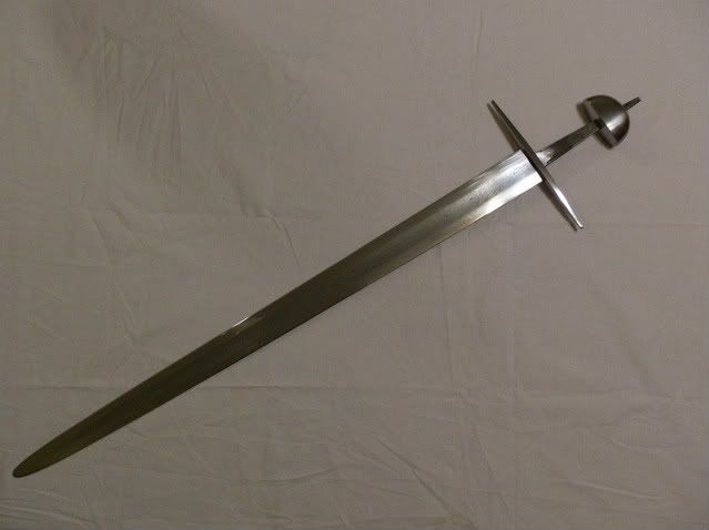

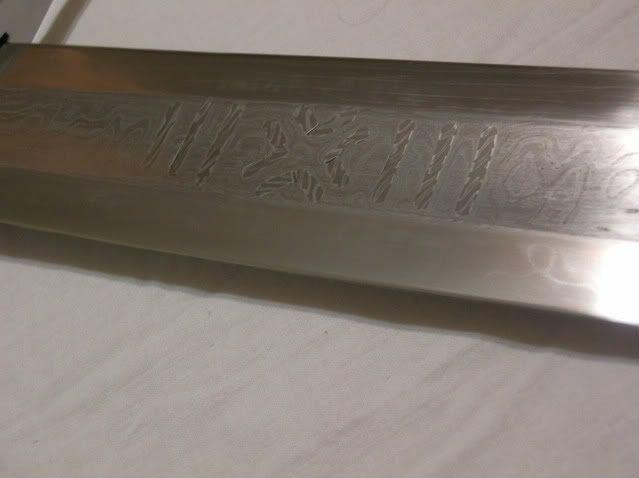

J. Helmes Posted January 31, 2012 Share Posted January 31, 2012 Here is a sword I have been working on. It is an Ingelrii with an iron cored blade with welded on steel edges. Jeff http://www.jeffhelmes.com Link to comment Share on other sites More sharing options...

Luke Shearer Posted January 31, 2012 Share Posted January 31, 2012 Wow! is that a hamon? The iron has alot of character. “Then something Tookish woke up inside him, and he wished to go and see the great mountains, and hear the pine-trees and the waterfalls, and explore the caves, and wear a sword instead of a walking-stick.” Link to comment Share on other sites More sharing options...

J. Helmes Posted January 31, 2012 Author Share Posted January 31, 2012 (edited) thanks guys, Luke, Yes it is a hamon. Dave, You do me far too great an honor by saying that. Edited January 31, 2012 by J. Helmes http://www.jeffhelmes.com Link to comment Share on other sites More sharing options...

Jeroen Zuiderwijk Posted January 31, 2012 Share Posted January 31, 2012 Wow! That's just incredible! Patternwelded inlays, wrought core, hamon on the steel edges. The only step up from that is shear steel in the edges (unless that's already the case?). Jeroen Zuiderwijk Facebook page: https://www.facebook.com/barbarianmetalworking Link to comment Share on other sites More sharing options...

J. Helmes Posted January 31, 2012 Author Share Posted January 31, 2012 (edited) Thank you for the kind words gentlemen! Jeroen- the blade has a 1080 edge. I stacked the edge steel from peices and the weld lines have etched. Its not shear steel but there is a slight piled steel look. Jeff Edited January 31, 2012 by J. Helmes http://www.jeffhelmes.com Link to comment Share on other sites More sharing options...

Richard Furrer Posted January 31, 2012 Share Posted January 31, 2012 Jeff, That is a good looking combination. What are its dimensions? I am sure the hilt will be worth looking at as well. Ric Richard Furrer Door County Forgeworks Sturgeon Bay, WI Link to comment Share on other sites More sharing options...

J. Helmes Posted January 31, 2012 Author Share Posted January 31, 2012 Thank you guys. The handle and scabbard will be leather covered. Ric, the blade OAL is 100 cm, the blade is 58mm wide at the hilt, and is 84.5 cm long. I will give the distal mesurments when I get it finished. Jeff http://www.jeffhelmes.com Link to comment Share on other sites More sharing options...

Jeroen Zuiderwijk Posted January 31, 2012 Share Posted January 31, 2012 Thank you for the kind words gentlemen! Jeroen- the blade has a 1080 edge. I stacked the edge steel from peices and the weld lines have etched. Its not shear steel but there is a slight piled steel look. Jeff I thought I noticed some layering Just shows that piled homogenous steel already adds a lot more character then just plain steel. Excellent! Jeroen Zuiderwijk Facebook page: https://www.facebook.com/barbarianmetalworking Link to comment Share on other sites More sharing options...
Mick Maxen Posted January 31, 2012 Share Posted January 31, 2012 Jeff, This is excellent and inspiring work. The inlays look very good against the iron core. Mick Link to comment Share on other sites More sharing options...
