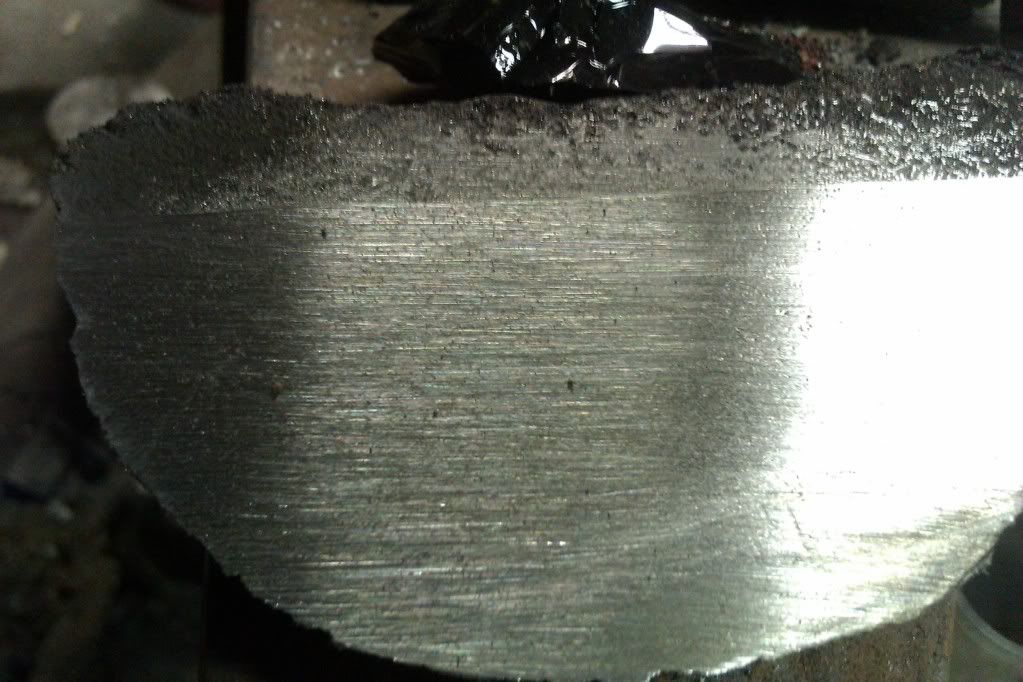

ZebDeming Posted March 24, 2012 Author Share Posted March 24, 2012 Wind powered would be pretty cool! The whine of a vacuum cleaner gets old pretty quick Well it wasn't a total failure today. Once things settled down in the crucible, I would add a bit more ore and charcoal. I finally charged a little over 300 grams of ore and then let it cook. At about 2 hours and 15 minutes in the crucible broke so I shut it down and extracted what I had. It wasn't liquid so I didn't loose what was in the crucible. After some sorting and chipping I had almost 90 grams of bits and pieces of iron It seems like cast iron, very crumbly under the hammer. I'm gonna fire up the forge tomorrow and see if I can stick it all together, we'll see. Even if it is cast, I've still made iron from rocks and I'm pretty happy about that. My furnace is now officially done for, and needs rebuilt, but I've got a burner from an oil burning boiler and a 2 gph nozzle for it that's gonna come in handy for the next furnace. My burner on this one is a siphon burner and it requires an air compressor to run, its quite the contraption Zeb Link to comment Share on other sites More sharing options...
Mark Green Posted March 24, 2012 Share Posted March 24, 2012 (edited) Spark it. If it is just sponge iron. Make you an Aristotle, and turn it into steel. If it is cast, save it to make some more crucible steel. Edited March 24, 2012 by Mark Green Mark Green I have a way? Is that better then a plan? (cptn. Mal) Link to comment Share on other sites More sharing options...
ZebDeming Posted March 24, 2012 Author Share Posted March 24, 2012 I don't know why it didn't occur to me to spark test it, duhhh. It sparks, but very dull and not alot of sparks at all. I'll see if I can take a short video. Link to comment Share on other sites More sharing options...
ZebDeming Posted March 24, 2012 Author Share Posted March 24, 2012 Here's a short video of the sparking on my 1x30. http://www.youtube.com/watch?v=fCokMPyCxKw&feature=youtu.be Let me know what you think, I'm still kinda new at this stuff. Zeb Link to comment Share on other sites More sharing options...
