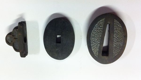

Stéphane A. Posted May 6, 2012 Author Share Posted May 6, 2012 Follow up... now ! Work on fittings, guard and pommel. A lot of work, probably around 8 hours. As I don't have the chance and the knowledge to cast stuff, I went the way of acid etching and engraving. File work I used nail varnish. Then glued a paper with wood glue and waited to set. I cut the design with a sharp cutter through to the paper and varnish. Removed the paper and glue with water. ( the design was taken and copied from pieces of the Staffordshire hoard) nitric acid bath for about 8 hours After the etch chisel and dremel to clean and deepen the engravings. It's difficult, I need training, the next will be better Pieces almost finished Next steps, carvings on the wood Thanks Stéph My link Link to comment Share on other sites More sharing options...

Dave Stephens Posted May 7, 2012 Share Posted May 7, 2012 That's GREAT work, man. Nice job with the acid etching and carving. Very bold. I'm sure you are learning a ton with this effort. Inspiring work! --Dave PS -- I see that you're using nitric acid as the etch. If that is brass, then ferric chloride etches it really well and it is WAY less dangerous than nitric. I used to use a 10% nitric solution to etch my damascus blades. That stuff is scary. Be careful man. Remember, always acid to water, never water to acid. Have a bucket of water with baking soda in it available. Chemical gloves and goggles (not safety glasses, but goggles that actually seal against the face) . . . (Sorry to get all OSHA safety crazy . . . ) -----------------------------------------------"It is not the critic who counts; not the man who points out how the strong man stumbles, or where the doer of deeds could have done them better. The credit belongs to the man who is actually in the arena, whose face is marred by dust and sweat and blood, who strives valiantly; who errs and comes short again and again; because there is not effort without error and shortcomings; but who does actually strive to do the deed; who knows the great enthusiasm, the great devotion, who spends himself in a worthy cause, who at the best knows in the end the triumph of high achievement and who at the worst, if he fails, at least he fails while daring greatly." -- Theodore Roosevelthttp://stephensforge.com Link to comment Share on other sites More sharing options...
Stéphane A. Posted May 7, 2012 Author Share Posted May 7, 2012 Thanks Dave, I'll tell you why I used nitric. But first, no problem with safety reminders. If not for me, it can be useful for others. I have the proper gear and protections to work with it. The choice of nitric was decided after some experiments I made last week. The ferric did etch well but turned the brass into a copper color grained surface that was really hard to remove. Nitic stayed much cleaner. I had both available. Scabbard fittings will probably be etched as well but I need to figure out an other way to transfer the design onthe pieces. Stéphane My link Link to comment Share on other sites More sharing options...

Stéphane A. Posted May 7, 2012 Author Share Posted May 7, 2012 Hi Mark, I thought about it as I saw your experiments. However I'm not sure it will look good enough. I prefer to dip the fittings in ammoniac for some days and polish the high spots. I wish we could find oven hardening garnets in paste Stéph My link Link to comment Share on other sites More sharing options...

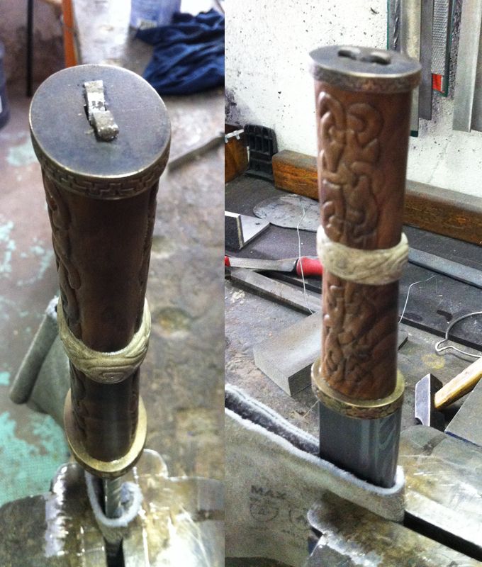

Stéphane A. Posted May 14, 2012 Author Share Posted May 14, 2012 (edited) Hello Next steps ont the Langsax project: The brass fittings spent over three days in ammoniac. They came out very dark, exactely the way I wanted. A light brush and polish will reveal the carvings. Carvings on the walnut parts, some steps of the process. Also on the reindeer. I like this material. I never carved that before. Getting pieces together, peening the tang. One picture is missing, the one with the nailed pommel hiding the tang. It was too dark for the final pictures but it is almost finished. One or two touch ups and sanding and done for this part. I counted 12 hours carving and 4 to mount the handle. 58 hours work so far. Pictures of the finished Langsax to come soon. Thanks Stéphane Edited May 14, 2012 by Stéphane A. My link Link to comment Share on other sites More sharing options...
