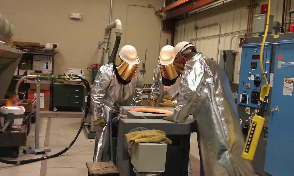

A. Humphrys Posted February 26, 2013 Author Share Posted February 26, 2013 John, I'd just about kill for a shop like this of my own. That said I couldn't afford to run it for more than a month. I'm grateful for every chance to work with VT's facilities now that I'm an alum. Bruce, 8620 makes some great base material for other steel alloys. But in the end you might be correct. I don't have my technical books in front of me at the moment, but i doubt that 8620 quenches too hard. I seem to remember it has some cold work potential though.. But don't hold me to any of that. As for induction hardening... I'm going to leave that to the experts.. and the guys with the cool induction forges. And here's the reason why.. a high power induction forge runs at 25 kVA which is equal to 20kW. The induction controller pictured above runs at 125kW. The leads that run to the coils are braided copper about 1 inch in diameter and you must be a certified electrician to even open the case. In short, it's far too much power for me to mess with. That said, there is plenty of power to get the job done. The alloying supplies are in route. We should be back at it some time next week. I will try to get more detailed photos of the molding process and the pouring process. Link to comment Share on other sites More sharing options...
Richard Furrer Posted February 26, 2013 Share Posted February 26, 2013 125KW inductortherm unit with flow through cooling and tilt furnace...most likely running 3,000Hz? looks like a $105,000 system there....less the discount to educational institutions. Good thing to have access to. I prefer Pillar or Tocco/Ajax, but....you use what you have. I'm sure you will work this out and make good tools. Ric Richard Furrer Door County Forgeworks Sturgeon Bay, WI Link to comment Share on other sites More sharing options...

Robert Dark Posted March 2, 2013 Share Posted March 2, 2013 Is that an Inductotherm furnace? My Stepson installs them for EMSCO, a part of Inductotherm. Cool stuff. Can't wait to see your NEXT finished product. Robert Dark Custom Knives Link to comment Share on other sites More sharing options...
