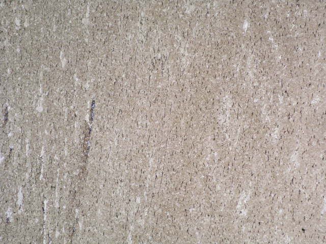

Jan Ysselstein Posted February 21, 2015 Author Posted February 21, 2015 (edited) I think the wootz types need to see some non imaginary grain boudaries, this is ingot #10. I would not get too enthusiastic interpreting this image, it is crude, dirty and is still much in the decarb layer. I suspect the initial dendritic structure is still partially evident here...so much linear alignment here. Edited February 23, 2015 by Jan Ysselstein
Jan Ysselstein Posted February 22, 2015 Author Posted February 22, 2015 (edited) I will be grinding the surface of all the ingots and removing the hard corners...to prevents cracks from growing into the forging. There is still a good chance some of these will break ( #2 is a bust from the start ). Looking at the material through a loupe, tells me I need to change the formula to 1.6% carbon from 1.8% carbon. I will do that on the next set. I hope to have some 1/2" thick bars by next week end. Jan Each ground ingot will be slowly brought up to the soak temperature in the little gas forge...held for an hour min. and forged. A charcoal/coke forge ( Murray Carter forge ) will be used to finish the forging down to 1/2" in thickness. Now two points in the process provide important information to the maker, the ingot and the bar. Jan Edited February 23, 2015 by Jan Ysselstein

Jan Ysselstein Posted February 24, 2015 Author Posted February 24, 2015 (edited) Dave, Thank you, it is a lot of work ...and as my wife keeps pointing out to me...a lot of expense. It is absolutely worth it. I was just sitting here looking at the pics of the first forging....,a rough grind and an etch. If I grind too much, I will get a good look at the structure but lose a lot of material in the process. There is sooooo much decarbed material to see it is easy to assume it is part of the structure. I have a good feel for what is going on..I think I am just at the upper level for carbon.( at 1050 C). Here is a pic showing the very first development of bands at the expense of the grain boundary cementite...this is the surface area of what will become a blade so the spacing is off but the width of these bands will grow. Jan Edited February 28, 2015 by Jan Ysselstein
Jan Ysselstein Posted February 24, 2015 Author Posted February 24, 2015 That was bar #1 here is a pic of bar #3 showing what I hope is carbon on the move. The surface area of this bar will be increased by about 3x the current surface area. Now is the time at which I have to decide in which directions to grow that area.
