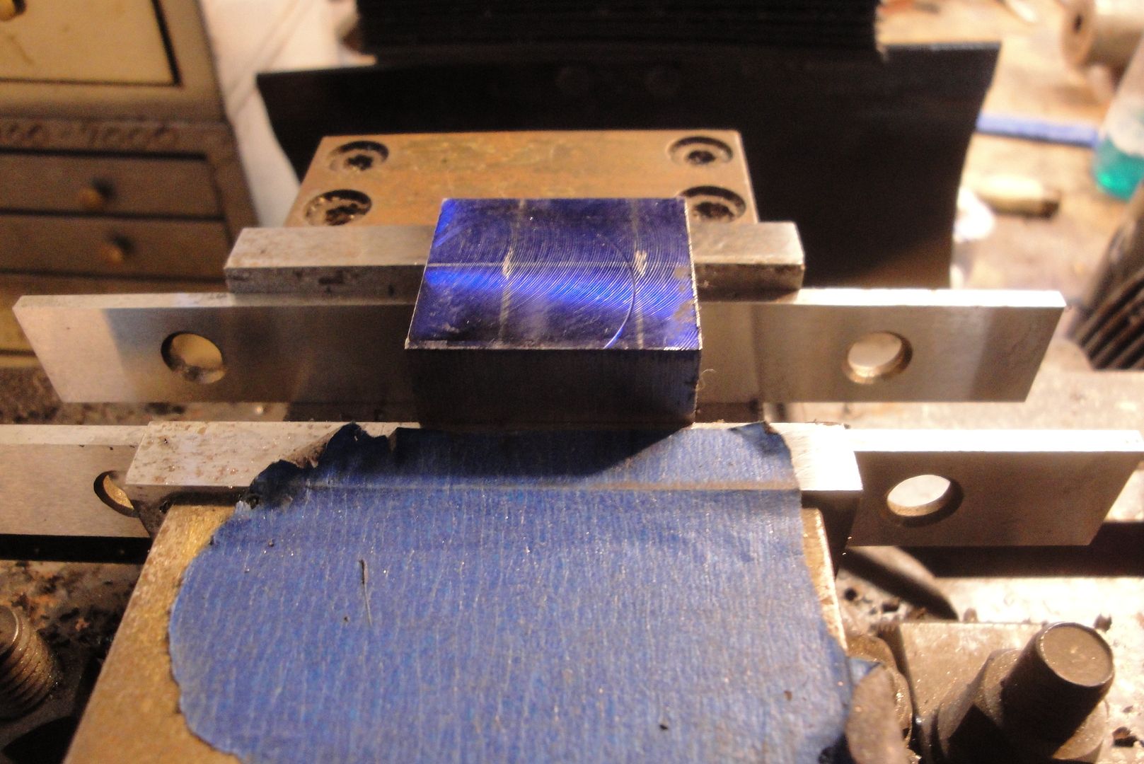

Kevin Colwell Posted February 12, 2015 Author Share Posted February 12, 2015 (edited) More of the process... Squared at 3/8", with 64 twisted layers of W2 and 15N20 Cut into 4 pieces (6" each) and mill two sides of each piece flat and square. this is the vise on my Rong Fu mill bought through Bolton Tools. It is a big benchtop mill, and pretty good for benchtop. Ain't they pretty? Make a cross of 15N20, and put a bar of the twisted steels in each corner of the cross, then weld the ends. Also, you see it is on stainless ht foil, and a puddle of WD 40. I wanted to be safe, and not use flux. In fact, no flux was used at any point in this entire process. I did, however, wrap the 4-way billet in the foil, filled with WD40 to scavenge any O2. more to come... (edited to add: forgot- there was 24" of original twisted bar, and I kept part to make a maiden's hair patterned blade, so I used 4 sections of 4" each to make this mosaic, which then became the stock for two blades. I don't know when I will ever finish the second blade, if anyone wants to trade for a blade blank.) Edited March 2, 2015 by Kevin (The Professor) please visit my website http://www.professorsforge.com/ “Years ago I recognized my kinship with all living things, and I made up my mind that I was not one bit better than the meanest on the earth. I said then and I say now, that while there is a lower class, I am in it; while there is a criminal element, I am of it; while there is a soul in prison, I am not free.” E. V. Debs Link to comment Share on other sites More sharing options...

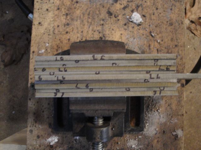

Kevin Colwell Posted February 12, 2015 Author Share Posted February 12, 2015 (edited) still going. I didn't have any pics of welding or drawing the billet. After it was welded and drawn a bit, I laddered it (I should have laddered it with a smaller cutter and more closely... I think). Now, finally, time to make a blade! OK, I had a lot of steel, and it was all made from this one big twisted bar. Two of them came from the 4-way weld packet (and thus have the River Eddy pattern thingy), the third is a Maiden's Hair (i.e., a the large twisted bar forged out into a blade). Edited to add: After thinking about it, I don't know when I will ever finish that middle blade blank. The maiden's hair on top is next on my list. If anyone wants to trade for that middle blank, let me know. It is, obviously, from the same mosaic block as the one below it, which is the focus of this particular thread. The rest of this will focus on the blade on the bottom of the picture, with the slightly raised point/clip as always for me, I refine the difficult parts with files. Here, I am getting the shape right where the bevel on top of the ridge meets the raised clip. working back into the bevel with a 4" safe-edge file. This is the best way for me to keep the ridge crisp and the lines straight. You can see that the rest of the bevel on top of the ridge has been filed, except for a few really deep grinder marks from the 36 grit cubitron. same process at the other end, although I had to use a needle file at the ricasso end, as well as the other two you just saw, to get everything just right. real blade pics with pattern coming next post Edited March 2, 2015 by Kevin (The Professor) please visit my website http://www.professorsforge.com/ “Years ago I recognized my kinship with all living things, and I made up my mind that I was not one bit better than the meanest on the earth. I said then and I say now, that while there is a lower class, I am in it; while there is a criminal element, I am of it; while there is a soul in prison, I am not free.” E. V. Debs Link to comment Share on other sites More sharing options...

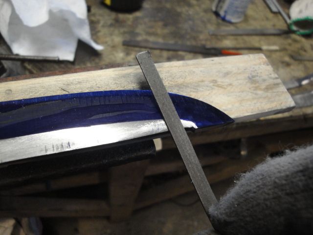

Kevin Colwell Posted February 12, 2015 Author Share Posted February 12, 2015 (edited) Still more... OK, I realize that was a lot of stuff. But, I wanted to show how the pattern was made, and see what people think about it. I sort of like it, as it seems like a river with eddies to me. Now that I have the blade done, I am going to work on the rest of the knife. It will have a curved bolser/guard thingy (bolster made of pwelded steel). The handle will be ebony, and hopefully it comes out looking a little like the NorthSea fighter handle in shape, but with a few key differences. Edited to add: As the project has evolved, I have moved away from the North Sea Fighter shape for the handle, and I am now going with a more Scandinavian look with different carving. I love the carving on the NS Fighter, but it doesn't go well with the pattern in this blade). I hope you like it. If you think it is not a good pattern or whatever, tell me now, before I go through the trouble a making more. Also, I am curious to know what the reaction is to this blade shape. It is very much like the ones being made in Scandinavia right now, and I think it is a good-looking and efficient design (maybe not my iteration of it, but the overall design, anyway). It is a lot different from bowies and a lot of the US fighters and stuff. So, I am not sure how people will react. Thanks for looking. take care, Kevin Edited March 5, 2015 by Kevin (The Professor) please visit my website http://www.professorsforge.com/ “Years ago I recognized my kinship with all living things, and I made up my mind that I was not one bit better than the meanest on the earth. I said then and I say now, that while there is a lower class, I am in it; while there is a criminal element, I am of it; while there is a soul in prison, I am not free.” E. V. Debs Link to comment Share on other sites More sharing options...

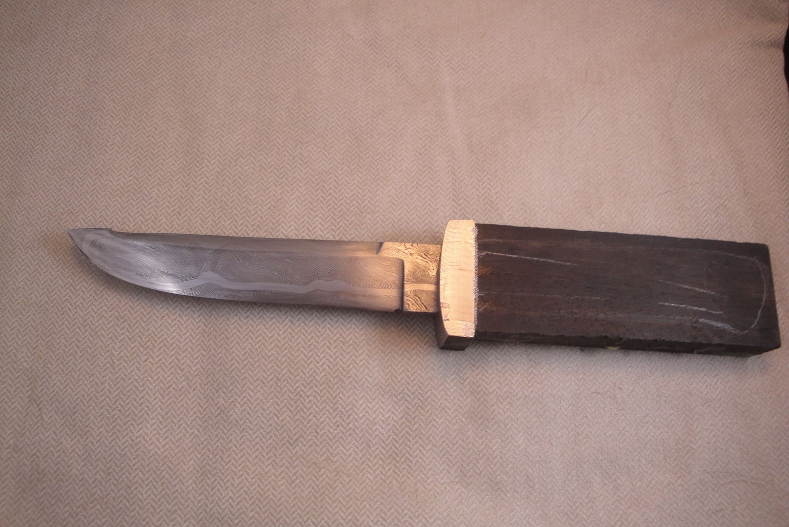

Kevin Colwell Posted February 25, 2015 Author Share Posted February 25, 2015 Hello All, I have been working on this project when I am able. I haven't made a ton of progress in some ways, but then in others, I have. I hope. This project requires either a big curved bolster, or one of those guards that is essentially a big curved bolster with a bit extending below the ricasso. It also requires sinking the knife down deeply into the bolster/guard. I haven't done this before, except by hot fitting (which isn't an option here). So, there has been a lot of making tagane and punches and chisels, as well as practicing with sharpening and heat treating them. I seem to have trouble with these aspects, and I have been focusing on improving and developing reliable/repeatable techniques. Here is the piece of steel I am using for the SECOND guard. More about that, later. Ebony for the handle. Now I have cut slabs and I am face-milling them flat. I love the mill for getting things flat. replaceable carbide cutters on the face mill. Nice and rigid (but not a Bridgeport). Now, I am using the mill to flatten and square the patter welded steel for the bolster/guard. please visit my website http://www.professorsforge.com/ “Years ago I recognized my kinship with all living things, and I made up my mind that I was not one bit better than the meanest on the earth. I said then and I say now, that while there is a lower class, I am in it; while there is a criminal element, I am of it; while there is a soul in prison, I am not free.” E. V. Debs Link to comment Share on other sites More sharing options...

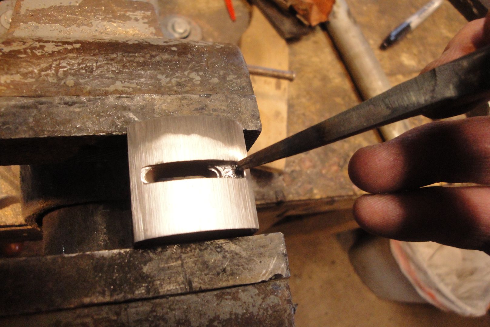

Kevin Colwell Posted February 25, 2015 Author Share Posted February 25, 2015 (edited) Still working... Here it is with the slot started on the mill, and the radius done with the KMG. Files, tagane, and punches, to get the pockets on the ends carved out. This is the area that I have had to struggle with. First, my only mill cutter that would not break for sure (that I wouldn't break, that is) was oversized. So, I had to do a lot of peening and polishing to get the slot to the right width. Then, I had to make and use the tagane. Most of them, I made too soft. That is, when I tempered with a torch, I tempered too much. I let them get to bronze/purple. On something that small, I was heating away from the tip and letting the temperature/color run down to the point, but I still overshot. I had to use a toaster oven, instead. Just a little straw color worked (tempering W1 at 350 F). I am carving poorly annealed 15N20 and 1084 with hardened and tempered W1, and so not over-tempering was important. I am about to heat treat it! I use this to keep scale down. It works well, too. Here it is after heat treatment. Looks great, no scale or anything. I spent about 30 minutes shaping, polishing and fitting after this, and that is when I noticed THE CRACK in the corner. You can't see it in this pic, or any pic. But, it is there. I was too confident, and I just quenched this thing in a bucket of water. after all, it is thick, right? I forgot about the stress risers at the corners. The crack starts right in the corner and runs down/along it. This is what it looked like. You can just see the crack in the upper right hand corner. It's there, for sure. Back to the drawing board (or anvil). Edited March 5, 2015 by Kevin (The Professor) please visit my website http://www.professorsforge.com/ “Years ago I recognized my kinship with all living things, and I made up my mind that I was not one bit better than the meanest on the earth. I said then and I say now, that while there is a lower class, I am in it; while there is a criminal element, I am of it; while there is a soul in prison, I am not free.” E. V. Debs Link to comment Share on other sites More sharing options...

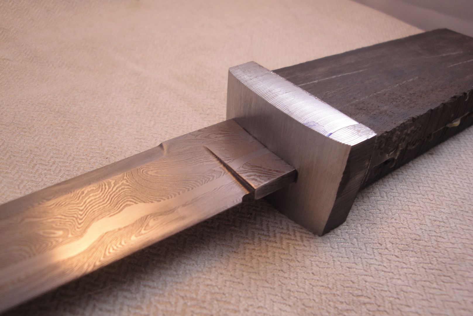

Kevin Colwell Posted February 25, 2015 Author Share Posted February 25, 2015 (edited) I won't bore you. Imagine that same sequence of stuff, all over again. Here is where I am, now. I still need to do a little more fitting. However, this pic exaggerates it, because the guard is not driven all the way up the ricasso. Obviously, I am going to round and shape it all, but first I have to fit it. You can see from this pic, I have enough material sticking down below the knife to make a curved guard. I am going to make one sort of like what Andre Anderssen does, and not a more modern style like you see on most ABS submission knives. I am very excited about the next stages of the work. This part will be a lot of fun. I love using hand tools to shape metal and wood. Also, the steel for the second bolster is sort of a mystery. I know what types it is made of, but I didn't write the layer count or pattern on it. Hopefully, it will look cool. thanks for watching. Wish me luck. This really is a fairly different approach to styling, and I am interested to see how it turns out. I know what I see in my head, and I hope this matches that at the end. The blade shape is growing on me. Your thoughts, hints, advice, etc. are welcome. take care, Kevin Edited March 9, 2015 by Kevin (The Professor) please visit my website http://www.professorsforge.com/ “Years ago I recognized my kinship with all living things, and I made up my mind that I was not one bit better than the meanest on the earth. I said then and I say now, that while there is a lower class, I am in it; while there is a criminal element, I am of it; while there is a soul in prison, I am not free.” E. V. Debs Link to comment Share on other sites More sharing options...

DanielQ Posted February 26, 2015 Share Posted February 26, 2015 The spine and belly lines are going to be very important on this knife, make sure you pay attention to them both during the sketching and the execution. Harmony is paramount.Sometimes I use the same tool I use for marking a straight middle line on the handle material, the straight line created by the blade that is. It's just a wooden board that looks like an L but with a larger bottom part, hold it against the blade and draw. To mark the spine line, press it against the spine and lay the upper part of the L along the handle. Gives a good visual help. (On the picture, it is the wooden thingy resting against the blade and extending over the back) This will look good, but I would've made the connection between the wood and the steel slightly concave/convex, gives it a bit more life I think. (This is a personal preference, most people do it straight)Looks very good so far, the blade is excellent and interesting. //DQ Link to comment Share on other sites More sharing options...
Kevin Colwell Posted February 26, 2015 Author Share Posted February 26, 2015 Daniel, thanks for the advice. Yes, I actually agree that the transition would look better concave/convex. Nothing is glued yet, as I have so much shaping and fitting left on the guard material, and then I have to polish and etch it. I may give it a shot, or I may not. At least, not on this one. On the next knife I am planning, there will be some rounded junctions between the materials in the handle. I am in agreement that such junctions look good. thanks again. kc please visit my website http://www.professorsforge.com/ “Years ago I recognized my kinship with all living things, and I made up my mind that I was not one bit better than the meanest on the earth. I said then and I say now, that while there is a lower class, I am in it; while there is a criminal element, I am of it; while there is a soul in prison, I am not free.” E. V. Debs Link to comment Share on other sites More sharing options...
