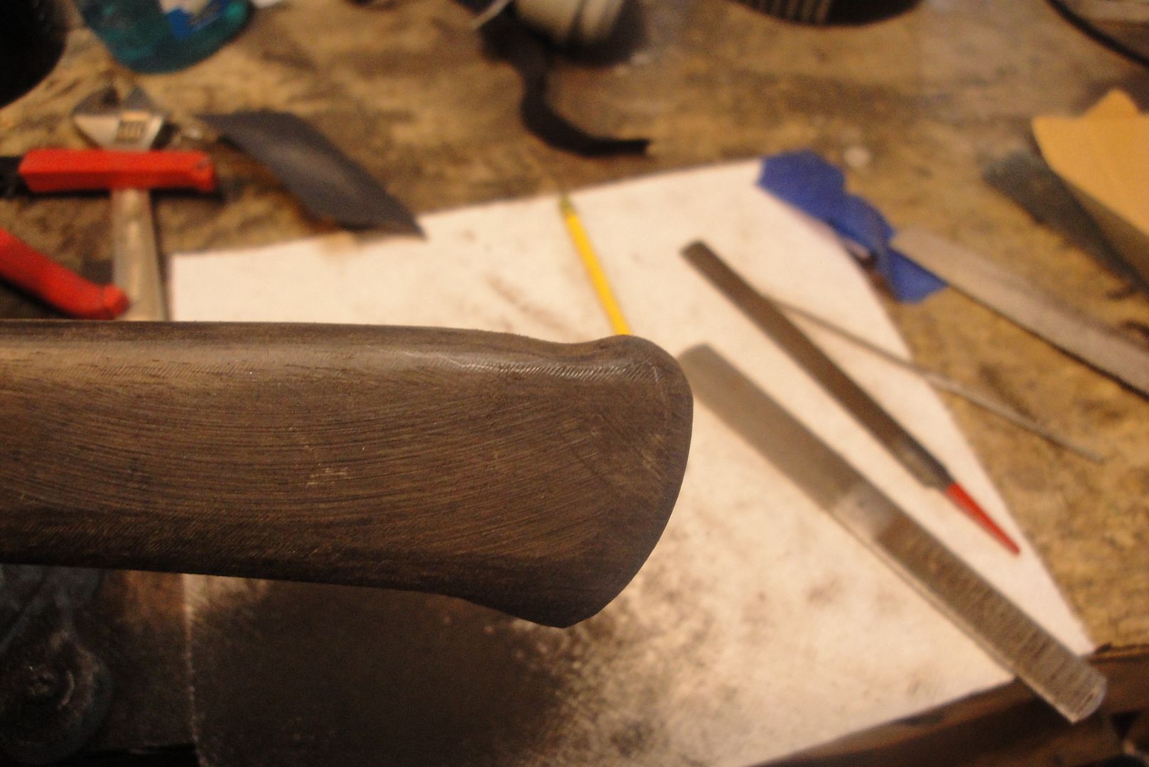

DanielQ Posted March 2, 2015 Share Posted March 2, 2015 It's coming along great, looking forwards to see how this turns out!I hope you don't mind me saying so, but the back-end would benefit from.. Something.. I got this critique a lot from the elders that the beginning and end should have something distinct about it. Maybe round off the actual back so the "end" line comes a bit forward towards the handle? Thus making the back more visible in profile and creating a sharp transition line. Hmm.. That doesn't make much sense.. I'll see if I have the time tomorrow to take some pictures or make a drawing, sorry, in a bit of a hurry now. //DQ Link to comment Share on other sites More sharing options...
Collin Miller Posted March 2, 2015 Share Posted March 2, 2015 Looks awesome!I agree with Daniel that the butt of the handle just needs something. I hate to sound like, "I'm not sure what, but just don't do that." Maybe a bit of a spur or something on the end just to give it a little more flare.Excited to see how it comes out though! “If you trust in yourself. . . believe in your dreams. . . and follow your star. . . you will still get beaten by the people who have spent their time working hard and learning things, the people who weren't so lazy.” ~ Terry Pratchett Link to comment Share on other sites More sharing options...
Kevin Colwell Posted March 2, 2015 Author Share Posted March 2, 2015 Daniel and Collin, don't feel bad for lacking precise words. I think I am in agreement with what you are trying to say. I am going to drop the line a bit and put the final shaping on the back, still. I haven't come up with exactly what I want to do with it, either. Right now, it is sort of like a golf club, but that is not my final destination. Still just getting there. The epoxy is drying, and there was a little shift in the glue up. However, I left everything just a tad oversized, so it doesn't hurt. When everything is set, and I can get some more shop time, I will finalize the shape and start polishing. I can only take a little off of the back in terms of length, but I plan to make the curve sharper and more angled towards the forward as it slants from top to bottom, which will lose a lot of extra bulk on the bottom by the heel, but still have the heel end up in the same place. thanks for taking time to comment. kc please visit my website http://www.professorsforge.com/ “Years ago I recognized my kinship with all living things, and I made up my mind that I was not one bit better than the meanest on the earth. I said then and I say now, that while there is a lower class, I am in it; while there is a criminal element, I am of it; while there is a soul in prison, I am not free.” E. V. Debs Link to comment Share on other sites More sharing options...
DanielQ Posted March 3, 2015 Share Posted March 3, 2015 Oh aye, I've very very nearly botched up when glueing on a fully finished and engraved knife handle recently... The blade slanted a bit in the hole and left the hole thing crooked. Always nervous when finishing handles before I glue em now because of that :-). Good thing you left a bit of material! Anyway, I did a quick sketch this morning for the sake of discussion. It is likely it is not suitable for this knife in particular, this depends on the plans you have. And in general, I believe it is better to follow ones own plans while listening to others suggestions and thoughts, and then putting them into the next project if the points were good. But this is something along the lines of what I was thinking. Just to try and create a not so sudden end, yet at the same time a bit more distinct. //DQ Link to comment Share on other sites More sharing options...
DanielQ Posted March 3, 2015 Share Posted March 3, 2015 Oh shit, sorry! Forgot to cut the picture. The top sketch you can disregard, it is just a quickie I did on a different subject //DQ Link to comment Share on other sites More sharing options...
Kevin Colwell Posted March 3, 2015 Author Share Posted March 3, 2015 Daniel, thanks for taking the time to help me work through this process. I truly appreciate it. I like the shape of the end you suggested. The decorative filework at the end may or may not end up on this one. I have to see when I have the handle closer. In general, though, I like that approach. I am planning to use some reindeer horn and silver on the next piece, and that sort of filework will be right at home. I am also trying to build a better jig to hold things together at glue up. If not, then I will have to start putting hidden alignment pins. It is just that there is not a lot of wood around the tang hole, and putting little pins there would be very tricky. thanks again for taking time to sketch. kc please visit my website http://www.professorsforge.com/ “Years ago I recognized my kinship with all living things, and I made up my mind that I was not one bit better than the meanest on the earth. I said then and I say now, that while there is a lower class, I am in it; while there is a criminal element, I am of it; while there is a soul in prison, I am not free.” E. V. Debs Link to comment Share on other sites More sharing options...

Kevin Colwell Posted March 5, 2015 Author Share Posted March 5, 2015 Thanks Kip. Ok, this is the last round of pics for this one. Thanks for following along. I haven't ever made a thread this detailed, and it has been fun. I won't do it all of the time, but it is fun sometimes. I have this huge round file/rasp, and I use it for getting radii. It would also make a good weapon if I can't get to one of the small hammers in time. Not that I ever think about these things, of course. Cleaning up with half-round. flat side of half-round for transition. this will be refined a lot more with 200 grit paper backed by the smooth-ground old file. You can do a lot by changing how much paper is wrapped around a hard backing, to change the way it cuts. Rasping the end to get a better curve. doming the back. This wraps up all of the major shaping. There was a lot done with abrasive papers, too. Mostly, I use 200 grit rhynowet with the file backing it (no teeth on the file anymore). With a lot of paper turned around the file, you can use it to smooth over ridges and facets that you don't want. With just one layer of paper, you can use it to emphasize ridges and facets that you do want (I know that almost all of you do that regularly. I am just including it because someone new may care). please visit my website http://www.professorsforge.com/ “Years ago I recognized my kinship with all living things, and I made up my mind that I was not one bit better than the meanest on the earth. I said then and I say now, that while there is a lower class, I am in it; while there is a criminal element, I am of it; while there is a soul in prison, I am not free.” E. V. Debs Link to comment Share on other sites More sharing options...
Kevin Colwell Posted March 5, 2015 Author Share Posted March 5, 2015 OK, this is it. I was going to carve the wood, but this ebony is quite chippy. Plus, I carve badly, and I don't want to ruin it. The next one will have some decorative filework or carving. This one wants to be done, though. Here is the other reason for no carving - I dropped the knife once, and a big chip came out of the handle at the heel. So, the heel, where I planned to do a lot of the filework and/or carving, is now much smaller than I originally planned. Not a lot of room to take things off. Thanks for reading this far. It has been a fun process. I hope you liked sharing it with me. I also hope you like the knife. Comments are, as always, welcomed. please visit my website http://www.professorsforge.com/ “Years ago I recognized my kinship with all living things, and I made up my mind that I was not one bit better than the meanest on the earth. I said then and I say now, that while there is a lower class, I am in it; while there is a criminal element, I am of it; while there is a soul in prison, I am not free.” E. V. Debs Link to comment Share on other sites More sharing options...
