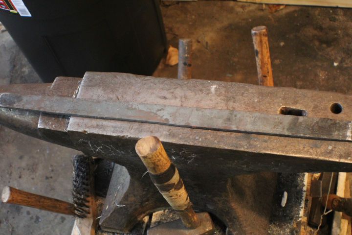

Kevin Colwell Posted December 31, 2015 Author Share Posted December 31, 2015 (edited) Here comes more... At this point, it has been welded with squaring dies, then squashed with a 1" stop in the press, with 90 degree rotations between squishes. Finally, I have started forging, "on the diamond," with this same 1" stop in the press. I will eventually forge this flat, using a .75", then a .5" stop in the press, all on the diamond. I have found that gentle, controlled movement, is better for this pattern (and also for the more traditional multi-bar twist billets- I ruined the last blade by screwing up the pattern with aggressive drawing in the press. Blade was great, but the pattern didn't look right, so new blade was needed). .5" stop in the press. Mosaic welded and flattened. Layout for laddering (I just cut the grooves with ye olde angle grinder). Laddering grooves cut in. Bar for sword forged out, complete with all tapers. No real bevels yet, though. The pattern is a diamond shape, with the edged being essentially twisted crushed w's. They will benefit from being ground into a lot. layout for grinding. draw filing edges, prior to layout for grinding. rough grinding done, point ready to be filed in. whole blade rough ground. Ready for filing. No secret, I do the precision work with files, and then refine with drawfiling. I do the same with a ridge on a single-edged blade, but I do grind a bit closer on those. Remember the advice from Don Fogg's old tutorial, get a good, flat blade, and then approach the flat slowly to create a crisp ridge! This was to make sure the blade surface is truly flat! Grinding lengthwise on platen with magnet. You have to learn how to do this with a blade that has non-linear distal taper, but it can be done. It is worth the work for the benefit. Edited January 11, 2016 by Kevin (The Professor) please visit my website http://www.professorsforge.com/ “Years ago I recognized my kinship with all living things, and I made up my mind that I was not one bit better than the meanest on the earth. I said then and I say now, that while there is a lower class, I am in it; while there is a criminal element, I am of it; while there is a soul in prison, I am not free.” E. V. Debs Link to comment Share on other sites More sharing options...

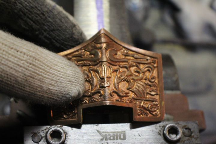

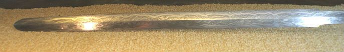

Kevin Colwell Posted December 31, 2015 Author Share Posted December 31, 2015 (edited) Last set for today! file guide for shoulders. making sure the shoulders are at the right angle to the blade to get the guard to line up perfectly with the ridge line. Get a look at that guard! Great stuff, isn't it? Here is the whole blade. It is 21.5" from shoulders to point, 1.25" wide at shoulders. There is a profile and a distal taper. The blade is .25" at medial ridge at the forte (which is the size of the hole in the guard - I met my goal!). It tapers to .15" at about 3" from the point, and slowly tapers down to .13" from there. The first three or four inches of the blade from the forte taper pretty rapidly in thickness, and somewhat in profile, then the taper becomes very gradual until the last 3 inches. The tang is about 10" long. I have not actually measured it, but the final goal is 10-12". There were a lot of short swords with these long handles carried during the Han Dynasty. They were sort of like wakizashi, in that they were carried by civilians and soldiers, alike. These were very common personal side arms. The long handle provides counter balance, and I think could be used as an extension of the short blade in a pinch. OK - here is the fun part. Here is a sneak-peek at the pattern. It is very rough, and not heat treated. It will change a good deal on the sides, and become more interesting, due to grinding. But, this is an idea. The cross of 15N20 leads to the long shiny lines that run up each side. It is these, with all of the undulations between them, that make this pattern remind me of a river. Of course, this view of the pattern comes from when the blade was totally flat, so the final pattern will be a lot different from this, and better! Remember, the edge elements are essentially twisted w's. They need the grinding to really shine. Wish me luck. More to come, tomorrow, hopefully! comments are welcomed, as always. kc Edited December 31, 2015 by Kevin (The Professor) please visit my website http://www.professorsforge.com/ “Years ago I recognized my kinship with all living things, and I made up my mind that I was not one bit better than the meanest on the earth. I said then and I say now, that while there is a lower class, I am in it; while there is a criminal element, I am of it; while there is a soul in prison, I am not free.” E. V. Debs Link to comment Share on other sites More sharing options...

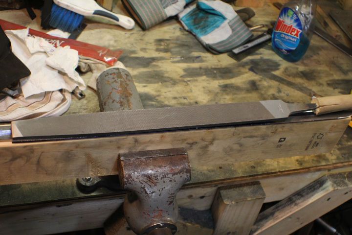

Kevin Colwell Posted December 31, 2015 Author Share Posted December 31, 2015 Here is the progress for today. Good news - the sword survived heat treatment. So, if I can shape it right for the remainder of the build, it will live! Getting started with the big bastard file. smaller file for the tip. still push filing at this point. I had to heat it and straighten it at one point. The grinding a filing let it bend. push filing the body of the blade. This is what it looked like when it came out of the Parks 50. Big thanks to Matthew Parkinson for the hardness testing chisels I bought from him. These were perfect for this situation. You see, my heat treatment kiln draws more power than my generator can supply. So, I had to heat treat this sword in the forge. Having the chisels to test the hardness was a great asset. It is alive! Here is another. I am excited. I think it will be nice when I am done. The fittings are awesome, and I am working hard to make a blade that can go with them. Until next time, kc please visit my website http://www.professorsforge.com/ “Years ago I recognized my kinship with all living things, and I made up my mind that I was not one bit better than the meanest on the earth. I said then and I say now, that while there is a lower class, I am in it; while there is a criminal element, I am of it; while there is a soul in prison, I am not free.” E. V. Debs Link to comment Share on other sites More sharing options...
Kevin Colwell Posted January 10, 2016 Author Share Posted January 10, 2016 The blade is heat treated and polished. Here we go... I hardened the blade, and then tempered it to 57 RC, as measured by Matthew Parkinson's harness chisels. The blade is 21.5" long, and it is more than half 15n20, so I thought that would be soft enough. If anyone thinks I am wrong, please tell me, so I can soften it a tad. The above pic shows the Simmonds Black Oxide Smooth Cut file that I used to draw file after heat treat and final grinding. I set the bevels on this with the files, and then used the grinder as a sander to take out the file marks. I had the KMG down to about 30 percent, and just removed file marks. I did most of the actual shaping and removal with files. Speaking of using files for shaping, this pic shows the amount of swarf created by drawfiling for 10 secs with a smooth-cut file. In this one, you can see the ripples caused by the belt grinder. Even when using the platen correctly, the belt bunches near the edge, so the bevel isn't really flat. Drawfiling fixes this. Polishing begins, 220 grit Rhynowet backed by a file that has been ground smooth. This is what it looks like when 220 grit hand sanding meets 400 grit machine finish. They meet at the ridge. On to the next part of sanding, 400 grit. The two most important tools for this are above. The optivisor makes sure that I can actually see and remove all of the scratches. I use the file with just one layer of paper on it (smooth ground old file, remember, no teeth) to polish the ridge. I wrap a couple of layers around it to polish the edge. I did this with 220, also. This gives a blade that is slightly convexed from about a third of the way down from the ridge out to the cutting edge. Just what it should be! please visit my website http://www.professorsforge.com/ “Years ago I recognized my kinship with all living things, and I made up my mind that I was not one bit better than the meanest on the earth. I said then and I say now, that while there is a lower class, I am in it; while there is a criminal element, I am of it; while there is a soul in prison, I am not free.” E. V. Debs Link to comment Share on other sites More sharing options...

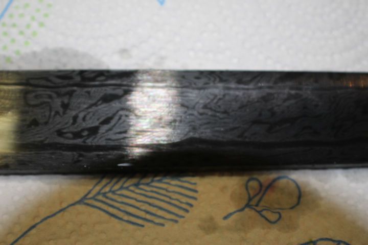

Kevin Colwell Posted January 10, 2016 Author Share Posted January 10, 2016 Here comes the fun stuff. I have the blade hanging like this for touch up on each side after sanding. The side I polished first and then taped often needs the most touch up. Here it is just out of the etch. oooh, aaaahhhh. I always love this moment! crappy full-length pic first Now, the tip! And the ridge! This is why I called it the River Jian. I used the pattern that has the two lines of 15N20 running vertically up the blade, and it reminds me of a river with lots of eddies and swirls and stuff. Here is the whole blade for perspective. It has a 10" tang, with a 21.5" blade that is 1.25" wide at the forte. I still have to do just a little filing where the two bevels meet to form the point. That is going to be close and delicate work. It will cut and thrust well for a blade of its size, though, for sure. Plus, that tang will have a 12" handle on it soon, and so you will have the option of choking down on the handle to get extra extension if you are in a situation that calls for it. OK, that is it for now. The blade is DONE! Now, I have to modify the tang a tad to get the fittings to work. That will be next. This has been an exercise in persistence for me. This is the 4th blade I made for these fittings. One, the hamon didn't look right. Two, the blade broke when straightening. Three, the twisted bars got out of alignment. So... Four, the River pattern mosaic (4-way with twisted and crushed w's, put in a cross of 15N20, welded, squashed on the diamond, drawn out, laddered, and forged). This blade won't be ashamed to be seen in public accompanying Charles's lovely fittings, I hope! Comments are always welcomed. thanks for looking, kc please visit my website http://www.professorsforge.com/ “Years ago I recognized my kinship with all living things, and I made up my mind that I was not one bit better than the meanest on the earth. I said then and I say now, that while there is a lower class, I am in it; while there is a criminal element, I am of it; while there is a soul in prison, I am not free.” E. V. Debs Link to comment Share on other sites More sharing options...

Collin Miller Posted January 12, 2016 Share Posted January 12, 2016 You're killing it! That pattern is sweet.One question I have is: when I'm draw filing, it has trouble biting well, and easily gets clogged and gouges my blades. How do you remedy this? “If you trust in yourself. . . believe in your dreams. . . and follow your star. . . you will still get beaten by the people who have spent their time working hard and learning things, the people who weren't so lazy.” ~ Terry Pratchett Link to comment Share on other sites More sharing options...
Kevin Colwell Posted January 12, 2016 Author Share Posted January 12, 2016 I used to have that problem, too. It is simple, take short and fast strokes, lift the file often. Also, clean the file often. I use a nylon brush, a file card, or the side of a very thin piece of brass, actually the corner of the brass. Just depends on what is stuck. The nylon brush I use very often (like every couple of minutes). Black oxide files my gall a little less, but I was using them because they seem to be a little harder. Filing stuff as hard as this wears your files out (I went through the best part of 2 or 3 with this blade). Matt - I will let you know. I need (and want) to make a dao next. You can put one of these together in an hour or two. kc please visit my website http://www.professorsforge.com/ “Years ago I recognized my kinship with all living things, and I made up my mind that I was not one bit better than the meanest on the earth. I said then and I say now, that while there is a lower class, I am in it; while there is a criminal element, I am of it; while there is a soul in prison, I am not free.” E. V. Debs Link to comment Share on other sites More sharing options...
