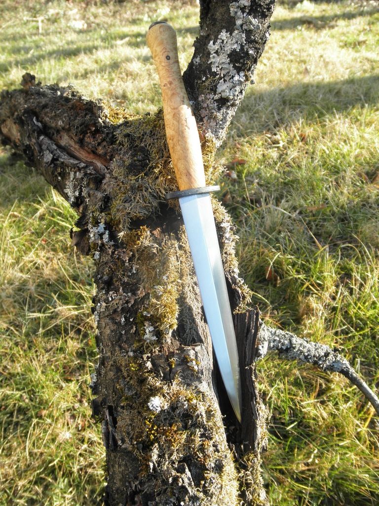

Lukas MG Posted February 27, 2017 Author Share Posted February 27, 2017 Finished: Fairbairn-Sykes Revisited And here it is all done! I‘m happy with how it turned out, it‘s a very elegant dagger that has a quite dangerous feel to it. It‘s light and quick in hand, yet not unsubstantial. The blade is quite massive with a thick spine and a convex distal taper. The edges are finaly honed and though the blade is plainly thrust-centric, its cutting capacity must not be underestimated. Stats: Overall length: 28.7cm Blade length: 17cm Blade width: 2.5cm PoB: 1cm Weight: 141g The design is very obviously based on the famous WWII fighting knife by Fairbairn and Sykes but I made some alterations. Functionally, my version is a better weapon with a more robust tang and stouter tip. The handle is wood and oval in cross section, unlike the round metal handle of the original. I read that there apparently were issues with the original having too step an edge angle for efficient cutting... can‘t comment on that but I can say that edge on my version is not to be scoffed at. It's not the sharpest blade I've ever made, the cross section just isn't designed for that but it will cut, no doubt. Aesthetically, I played a bit with contrasting materials and surfaces. The blade is finely polished 80CrV2, the handle a lightly colored, smooth piece of box elder while the guard and top cap are mild steel with a gnarly fire-finish. The tang end is peened over and left standing proud with the texture from the ball peen hammer. Overall, this was a fun piece to make. It came together pleasently quickly though I‘ll have to see when I can find time to make a suitable sheath for it... until then, thanks for looking! Cheers, Lukas http://www.lukasmaestlegoer.com Link to comment Share on other sites More sharing options...

Chris C-S Posted February 28, 2017 Share Posted February 28, 2017 Having a mate who was an Australian Commando in the veit and post era I know he would absolutely love something like this. His original issue is mounted on his wall. This looks good. I like the mild steel gnarly looking guard. I am new to knife making and I think sometimes me and no doubt others look for premium materials instead of what is readily available. Link to comment Share on other sites More sharing options...

GEzell Posted February 28, 2017 Share Posted February 28, 2017 I've always loved that design, even with it's faults it has a certain elegance to it. Beefing up the tang, making the handle cross-section oval, and tweaking the blade geometries makes this the knife the original wanted to be... Well done man. George Ezell, bladesmith" How much useful knowledge is lost by the scattered forms in which it is ushered to the world! How many solitary students spend half their lives in making discoveries which had been perfected a century before their time, for want of a condensed exhibition of what is known."Buffonview some of my work RelicForge on facebook Link to comment Share on other sites More sharing options...
Collin Miller Posted February 28, 2017 Share Posted February 28, 2017 Nice! The original was a great design and the tweaks you made are good improvements on that design. The wood grip is a nice touch as well. “If you trust in yourself. . . believe in your dreams. . . and follow your star. . . you will still get beaten by the people who have spent their time working hard and learning things, the people who weren't so lazy.” ~ Terry Pratchett Link to comment Share on other sites More sharing options...
Lukas MG Posted February 28, 2017 Author Share Posted February 28, 2017 I appreciate the comments! Glad you like it, including my "tweaks". Had some purists complain, lol @Kevin (The Professor): nah, I didn't think that far. Also, you can't make an oval shape on a lathe of any kind (as far as I'm aware). I drilled a pilot hole, burned the tang in, scribbled the handle shape on and ground away everything that was too much. I'm not a real wood worker, I treat everything like a stock removal project. Not a single rasp or file was used on that grip, all done with the angle grinder (I kid you not) and the belt sander. I did use a carving knife for the recess of the top cap but that was all. 1 http://www.lukasmaestlegoer.com Link to comment Share on other sites More sharing options...
Adam Betts Posted March 1, 2017 Share Posted March 1, 2017 (edited) Lukas, that came out beautifully! I love that box elder handle-- the movement in the grain makes the whole knife look like it's ready to jump into action on its own. Very nice work! 4 hours ago, Lukas MG said: I drilled a pilot hole, burned the tang in, scribbled the handle shape on and ground away everything that was too much. I did the same thing, since I don't have a lathe either-- the grip on mine is somewhere between a rectangle and an oval. I got really good at symmetrical carving making CO2-powered wooden racecars in shop class. A 36 grit aluminum oxide belt on the grinder just makes it go faster. Edited March 1, 2017 by Adam Betts Link to comment Share on other sites More sharing options...
