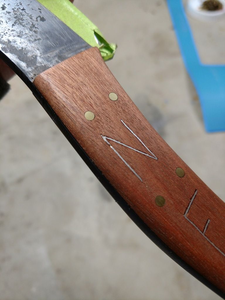

Nflanders Posted March 12, 2017 Author Share Posted March 12, 2017 so, a fair amount of progress on the second day working on the knife, but I have run into some issues with grinding... mainly that I have no clue what I'm doing, I am primarily using an angle grinder, and files at the moment, but I may switch over to sandpaper. Any recommendations (but I am happy that my edge is straight, and of a consistent width) Also working on inlaying wire into the handle out of (practicing with copper, but final product will be silver) Obligatory shop helper.. 2 Link to comment Share on other sites More sharing options...

jake cleland Posted March 16, 2017 Share Posted March 16, 2017 when inlaying wire into wood, if you flood the channel with superglue as you work the wire into place, it will help stabilise the surrounding wood against expansion and contraction with changes in moisture and temperature, as well as swelling the wood slightly to better grip the wire, and it will also be glued in place... Jake Cleland - Skye Knives www.knifemaker.co.uk "We can't solve problems by using the same kind of thinking we used when we created them." "Everything should be made as simple as possible, but not simpler." "Two things are infinite: the universe and human stupidity; and I'm not sure about the the universe." Albert Einstein Link to comment Share on other sites More sharing options...
Alan Longmire Posted March 16, 2017 Share Posted March 16, 2017 Another hint: use thin flat wire on edge. Put little nicks in the bottom edge if you can. Link to comment Share on other sites More sharing options...
Nflanders Posted March 18, 2017 Author Share Posted March 18, 2017 The copper wire is my practice wire ( it is a fair bit thicker than the silver I have for the final product ) and I actually sharpened/ roughed up the bottom edge of it with the dremel. It worked alright, but I need to make a bit finer chisel to use. I will definitely try the superglue trick on the next run. Also just ordered everything to make kydex sheaths as well. Link to comment Share on other sites More sharing options...
Nflanders Posted March 18, 2017 Author Share Posted March 18, 2017 Freshly quenched Getting that scale off... Into the oven... So, I'm new to all of this, but the guy that has been teaching my brother and I told me to preheat the oven to 425F put the knife in, then shut the oven off and leave it in for an hour as the oven slowly cools... (I believe that I'm working with 1095) Initials inlayed into (I believe mahogany or teak grips) in silver. Stabilized with superglue... Link to comment Share on other sites More sharing options...

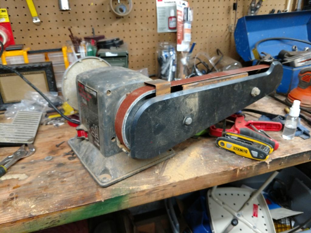

Nflanders Posted March 26, 2017 Author Share Posted March 26, 2017 So this is pretty much the final write up for the knife, I feel that I have learned a lot from building this knife ( whether through luck, or some roll of fate the heat treat seems to have worked out, knife took a 3 foot fall off the bench onto concrete tip first, and no chipping or bending) Got this guy for $30, hoping it holds up for awhile, plenty of torque for what I need for the time being. Down to 800 grit, and a couple of coats of Tung oil ( I believe the handle is mahogany, but not 100% ) That wire snagging issue that was mentioned ( inlaid the wire before shaping/ sanding ) Had to cut and replace a 3/32 x 1/16 piece. Homemade kydex press ( definitely need a softer foam ) polished up and sharp, this is about the point that I decided I was finished... after 5 tries, and finding out my rivets were too short the sheath is semi done, just waiting on the clips, and chicago screws... 1 Link to comment Share on other sites More sharing options...
