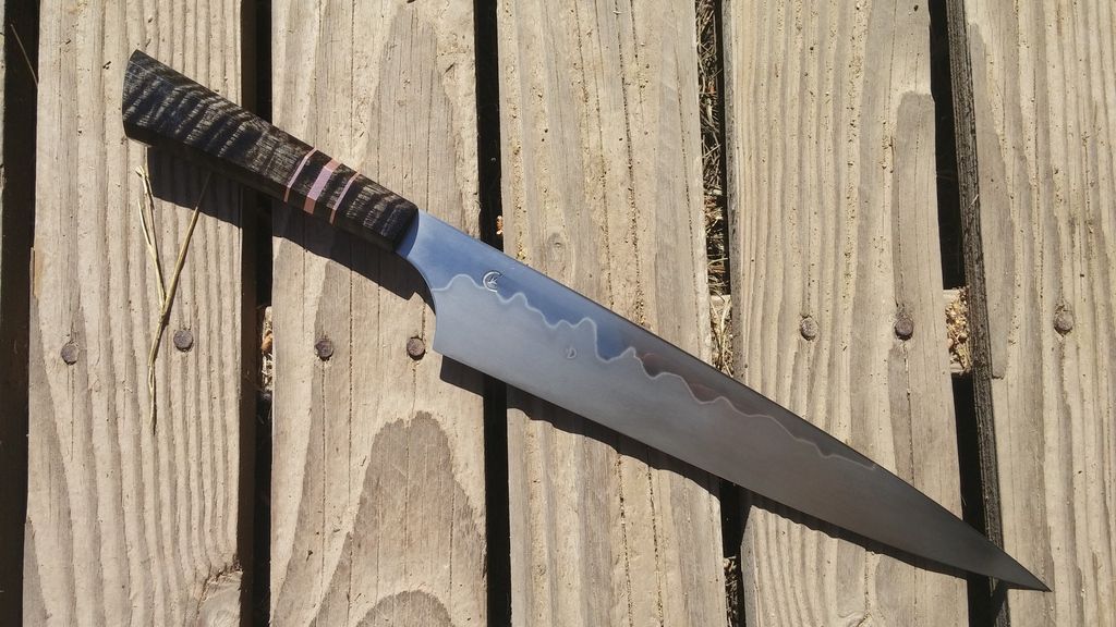

C.Anderson Posted May 17, 2015 Share Posted May 17, 2015 A few of my recent pieces . 270mm wa sujihiki, with musk ox, Oregon maple burl, and 5460yr old bog oak. I have better pictures of this knife somewhere, but I can't seem to find them. 265mm wa gyuto. 265mm wa gyuto, with black dyed Hawaiian mango, and reclaimed copper piping spacers. 280mm wa sujihiki. The handle was actually made by a good friend of mine named Mikey Riggen in Hawaii. Another wa sujihiki with a Mikey Riggen handle. This time with mammoth ivory and bog oak. The knife is 300mm long. 185mm ko-gyuto with more of the dyed Hawaiian mango, nickel silver, and 165yr old wrought iron that was a gift from my friend Dan Davis. Another pair of 185mm wa ko-gyuto with wa handles out of buckeye burl. All of the steel is W2 from Aldo, all of the wood (on my handles) is stabilized for kitchen use, and the vast majority of it comes from Mark Farley at Burl Source.Hope you enjoy Slow is smooth, smooth is steady, steady is fast, fast is deadly... Erik R. http://www.facebook.com/scorpionforge Link to comment Share on other sites More sharing options...
