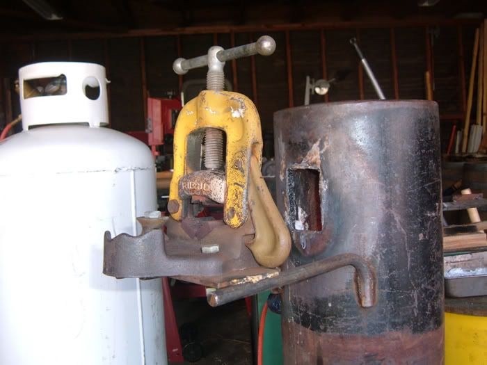

Brian Shafer Posted December 31, 2007 Share Posted December 31, 2007 This method may not be very practical for everybody out there but here it goes. I work in the oilfields and getting suitable wire rope for knife making is pretty easy. In fact I know were about 60 feet is just setting on the ground begging to be turned into knives. Anyhow, my forge is modified to hold a jig that allows me to twist the cable while still in the forge. It is a pipe vice mounted on a slide that allows me to move it back and forth or totally remove it. The idea came from Gene Osbourns dvd on making cable damascus. No Thor, no hammer. Know Thor, know hammer! Link to comment Share on other sites More sharing options...
Brian Shafer Posted December 31, 2007 Author Share Posted December 31, 2007 (edited) First, I cut the cable in sections about 4 feet long. Then I get the forge hot and feed the cable in about 6 inches at a time to burn off all the grease. After all the grease is burned off I allow the cable to cool off enough to handle. I then take all the strands apart and attack them individually with a wire brush. When they have all been brushed I reassemble the rope and get ready to weld. With the forge at welding temp I feed just enough cable through the forge so I can hold it in the vice. When the wires are hot enough I flux the heck out of them and then back into the forge. At this point I close the vice and wait for the rope to get to welding temp. When it is hot enough I twist the cable with a modified pipe wrench The wrench is a 14 inch pipe wrench with a handle welded to the top jaw. Works great for this application. I got that idea from the video by Jim Hrisoulas Since the cable is kept hot while you are working on it, twisting it up tight is really easy. Edited December 31, 2007 by starch No Thor, no hammer. Know Thor, know hammer! Link to comment Share on other sites More sharing options...

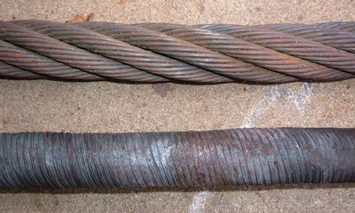

Brian Shafer Posted December 31, 2007 Author Share Posted December 31, 2007 After twisting as much as I like I take the cable out of the fire and to the anvil and hammer lightly to make sure the center is completely welded together. No Thor, no hammer. Know Thor, know hammer! Link to comment Share on other sites More sharing options...
Brian Shafer Posted December 31, 2007 Author Share Posted December 31, 2007 After welding the whole thing together I employ the services of my 11 year old son to help draw out the billet. The 8 pound sledge hammer teaches him who is the boss pretty quick No Thor, no hammer. Know Thor, know hammer! Link to comment Share on other sites More sharing options...
Brian Shafer Posted December 31, 2007 Author Share Posted December 31, 2007 The piece of cable I used here started out at 47 inches long with an o.d. of about 1.185 inches. After welding it was about 37 inches long with an o.d. of about 1.07 inches. The cable made one total rotation about every 7 inches before welding. After welding it made one rotation about every ¾ of an inch. I don’t worry about the very ends getting welded up. I end up cutting off about the first and last 3 or 4 inches. I think the welding process here (not including the cleaning part) took less than an hour. It would go faster if my forge was more efficient. Hope this is useful. Thanks for looking. Brian No Thor, no hammer. Know Thor, know hammer! Link to comment Share on other sites More sharing options...
Mike Blue Posted December 31, 2007 Share Posted December 31, 2007 That rig just about maximizes the success of getting either good tight cable or a good tight twist on any pattern welded material. A very nice solution. There are three kinds of men. The one that learns by reading. The few who learn by observation. The rest of them have to pee on the electric fence for themselves. Will Rogers Link to comment Share on other sites More sharing options...
Brian Shafer Posted December 31, 2007 Author Share Posted December 31, 2007 (edited) If I had to make this rig again I think I would use a chain vice instead. The pipe vice gets pretty hot. Chain vice might work a little better. Edited December 31, 2007 by starch No Thor, no hammer. Know Thor, know hammer! Link to comment Share on other sites More sharing options...
cwilliams Posted January 1, 2008 Share Posted January 1, 2008 Starch Nice idea on the pipe vise attached to your forge. I always thought of just putting a buddy on the other side of the forge but never have anyone around when I forge. Thanks for sharing. PS it really works that twist is about twice as tight as anything I get using the old fashioned method. Chris Williams Link to comment Share on other sites More sharing options...
DFogg Posted January 1, 2008 Share Posted January 1, 2008 Thanks for sharing, that looks as tight as anything I have seen. Don Fogg Link to comment Share on other sites More sharing options...
Mike Davis Posted January 21, 2008 Share Posted January 21, 2008 I have to say, that is the tightest cable weld i have ever seen. I want to tell you that i am stealing your idea and putting something like that on my forge. I love doing cable and always wanted to do the welds at full heat as to not lose the outer weld temp. an artist is not ahead of his time, he is his time. its just that the others are behind the times Link to comment Share on other sites More sharing options...
