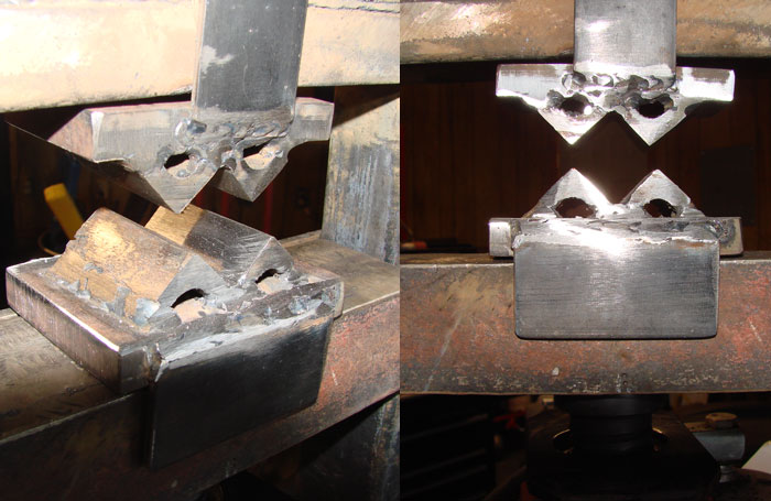

Thunder Posted May 28, 2008 Author Posted May 28, 2008 I made a set of squaring dies to press a 1" cable last week, the cable is 12" long, weight about 1 pound - Here is a graphic of my squaring dies they are made from cut down 1/4" 2 X 2 Angle iron, cut to about 3/4" sides and welded to 1/2" plate. I also I made about a two minute video of using them, the video is on youtube, located here The video is really compressed and I was just trying to show use of the dies, I cut out the fluxing, twisting, etc. It is just to show what can be done with this little press. T. A. Toler KNIVES PLUS ® Retail cutlery and cutlery accessories since 1987.
Thunder Posted May 28, 2008 Author Posted May 28, 2008 Almost forgot, final view of billet on the video is about 1760 layers, starts out with about 220 wires, folded to 440, folded to 880 folded to 1760. This billet was made last week it isn’t the one being shown on the video. T. A. Toler KNIVES PLUS ® Retail cutlery and cutlery accessories since 1987.
