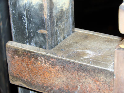

Thunder Posted August 7, 2008 Author Share Posted August 7, 2008 Tom if you are taking about the beam that sits on of the jack ram, it sits directly on top of the ram with no clearance. If you are talking about the clearance between the ram bar and the top beam, then that clearance is adjusted with the ram screw extension to just slightly larger than the depth of the piece you are pressing. I always try to minimize the ram travel as much as possible. If you are taking about the clearance between the bottom ram bar and the top brace/ Beam there is about 4 - 5” between the one I welded midway and the bottom ram bar. It would be better if I had made it adjustable. I am using mostly 1” X 2” flat bars for dies set material – I have used some ½” plate also. If you are taking about the clearance between the bottom ram bar and the uprights it travels on, then that is about as flush as I could get it, no more than 1/16” , - if the clearance between the uprights is to great and the jack isn’t centered, the travel upward will sometime become canted and the ram beam can get stuck. However it usually straightens out once it contacts the piece to be pressed. It took me several tries to get the bottom beam to travel smoothly up the posts. I had to file and smooth my old used 2 X 2 uprights and adjust the jack some so it centered. Then once everything worked I welded locating bars on the base where the jack sits to keep the jack base in position. Also the full travel that the jack ram can travel is about 6-1/2”, so clearance is restrained by this length, the screw extension length, and the maximum width of the piece to be pressed. If you are taking about clearance other than I have described just post back and I’ll try again. : ) Ken and Frogfish may have better/different ideas, what ever works is good, there is never only one way T. A. Toler KNIVES PLUS ® Retail cutlery and cutlery accessories since 1987. Link to comment Share on other sites More sharing options...
Tom Megow Posted August 7, 2008 Share Posted August 7, 2008 Tom If you are taking about the clearance between the bottom ram bar and the uprights it travels on, then that is about as flush as I could get it, no more than 1/16” , - if the clearance between the uprights is to great and the jack isn’t centered, the travel upward will sometime become canted and the ram beam can get stuck. However it usually straightens out once it contacts the piece to be pressed. T. A. Toler That's it T.A. I was afraid too much clearance it might bind. Link to comment Share on other sites More sharing options...

Thunder Posted August 8, 2008 Author Share Posted August 8, 2008 Tom I looked closer at my press last night, the clearance between upright and ram bar is pretty much flush. It took a lot of file work, and polishing to get it to fit and ride properly. Here is a pic of the interface: Fisher - I would love to see some pic when you get yours up and running. PS: 6011 always splatters, I have shirts that look like Swiss cheese from the burn holes : ) Hope this helps T.A. Toler KNIVES PLUS ® Retail cutlery and cutlery accessories since 1987. Link to comment Share on other sites More sharing options...
