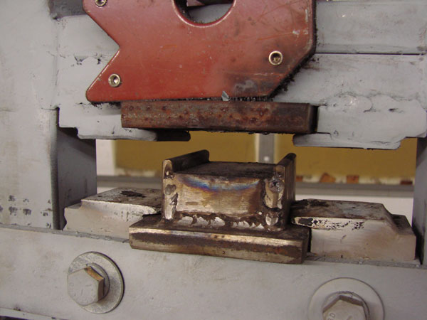

Thunder Posted January 27, 2009 Author Share Posted January 27, 2009 here is how my die set holders look: little lips to hold the die sets and upper magnet to keep top die from shifting. 1/2" plate steel for top die set, 1" X 2" lower with stops to keep plate at 1/4" thickness Crude but works pretty well. On my next press they should look much better. I have a new press in the works, should be a month or two before I can get to the shop to complete it. T.A. Toler KNIVES PLUS ® Retail cutlery and cutlery accessories since 1987. Link to comment Share on other sites More sharing options...
KPeacock Posted January 27, 2009 Share Posted January 27, 2009 My first die set-up was very similar to this. In the that hold the die down (or up) I drilled a hole and tapped it to accept a 1/4" bolt. This was necessary to keep the dies from shift foreward and backward while pressing and moving the billet. My current set-up has a retaining plate on the back of the press so that the dies can only move so far back. On the front side, havd a small piece of plate that pivots out of teh way to slide new dies in and out. When the new dies are in place, this piece of plate is simply rotated back into position to keep the dies held firmly in place so they done move fore and aft. I do like the 1/4" stop you have on there. I'll add those to my dies next time i get out in the shop. Have you ever thought about the life of steel? It's interesting to think that you can control the fate of a piece of metal. Link to comment Share on other sites More sharing options...
