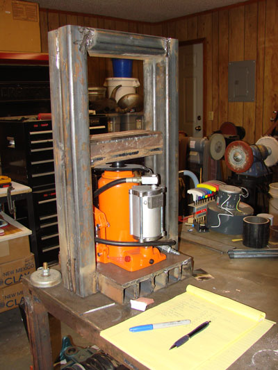

Brian Madigan Posted February 23, 2009 Share Posted February 23, 2009 Mine is finished and working. I had it running all weekend drawing out big square pieces of W2 into flat bars on flat dies. It works great unless the air compressor is acting up or too cold. I have an old oil lubed 1HP compressor that stops at 145 PSI and a compact 20 ton bottle jack. I have a couple of problems: 1- I built the bottom anvil out of two 1/2"x4x8 plates, so its only 1" surface for the die to sit on. It needs a wider surface to sit on. 2- I need a safer and more convenient control system. I'd like a single lever w/Up-Down control as you would have on an electro-hydraulic one. 3- I didn't make the anvils adjustable. The jack has 8" or so of adjustment on the screw, which is fine for now. 4- The top die hold downs broke the first time I put uneven pressure on them. They need to be much stronger. 5- I have to make more dies now, and they will probably be mild steel. I have flatting dies and material for drawing dies, but I don't have a good way of attaching the dies safely. Mild steel doesn't hold up to all day smashing after it starts getting really hot. I'd like to have some standard size die holders and a set of dies that I could use on a hammer or the press. Link to comment Share on other sites More sharing options...

Thunder Posted February 26, 2009 Author Share Posted February 26, 2009 Original press base dimensions 8" X 10" New press base dimensions 10" X 12" I made the base wider so the jack can be centered better, also width gives more room for the ram bar and anvil beam. I have dual uprights and twice as much room for larger/longer die sets. I am not using a movable top beam, I think the adjustable top on the jack will be fine for most of what I do. With a non adjustable beam, I do not have to worry about aligning, drilling, etc - the bolt holes. Also I do not have to worry about the holes stretching bolts failing and the frame is much stiffer. Personal choice, adjustable beam is fine, your choice. Here is a graphic of my new mini press: KNIVES PLUS ® Retail cutlery and cutlery accessories since 1987. Link to comment Share on other sites More sharing options...
Art Lawrence Posted February 26, 2009 Share Posted February 26, 2009 (edited) Thunder, I like the new model especially because I over-bought on the 2X2. Two questions: How long are the upright posts? What is keeping the ram bar in line when it travels? Thanks, Art edit: Is the ram bar a double 2X2? Original press base dimensions 8" X 10"New press base dimensions 10" X 12" I made the base wider so the jack can be centered better, also width gives more room for the ram bar and anvil beam. I have dual uprights and twice as much room for larger/longer die sets. I am not using a movable top beam, I think the adjustable top on the jack will be fine for most of what I do. With a non adjustable beam, I do not have to worry about aligning, drilling, etc - the bolt holes. Also I do not have to worry about the holes stretching bolts failing and the frame is much stiffer. Personal choice, adjustable beam is fine, your choice. Here is a graphic of my new mini press: Edited February 26, 2009 by Art Lawrence "My sword and my shield are at your command" Link to comment Share on other sites More sharing options...
Matt Bower Posted February 26, 2009 Share Posted February 26, 2009 It looks like the ram bar contains a plate that's riding in the slots between the uprights. Is that right? If so, what are the dimensions of that plate? Link to comment Share on other sites More sharing options...
Ken Kelley Posted February 26, 2009 Share Posted February 26, 2009 I like that wider base. If I had it to do over again I think I would go the same route. And, after having used my press for awhile, I also see the utility of the fixed top anvil. Even though I drilled three sets of holes I have yet to move the anvil from the middle where I first put it. I still might find a use for the other holes as time wears on but if I was planning to use the press just for squishing damascus billets I think I would go the fixed route. Maybe I'll make another one just for that purpose. Or maybe not. Depends on how ambitious I get when it warms up a little bit more. But, since the ice and wind storms of the past few weeks damaged so many of my trees I'll probably spend the warm months running a chain saw and clearing timber instead. I'll have plenty of firewood next winter for sure. K Link to comment Share on other sites More sharing options...
Thunder Posted February 26, 2009 Author Share Posted February 26, 2009 Ram bar isn't finished, it will have two outside guides installed as on the old style press. In the graphic the guides are laying just behind the press, in front of the fan. Matt I though about your idea, but felt the uprights would be stiffer if they were welded tight instead of having a center gap for the travel. The center gap may be the way to go - I'm not sure. The top plate size is 1/2" thick X 10" X 4 1/2". Bottom plate is 1/2" x 10" X 4" - Uprights are 4" wide - add 1/2" to top plate - making it 4 1/2" to accommodate the 1/4" guide thickness. That keeps the press area smooth. Confusing, I'll try to make a picture to better explain. Art I will measure the uprights when I get home tonight for dimensions. I used dual uprights because I had a 20’ joint (1/4” wall thickness) of the square tubing, and thought I might as well use it all, makes the press stiffer. There will be a small section of pipe welded to the center of the ram bar at the bottom the jack head will fit into the pipe to keep it centered - I hope : ), aligning everything where it rides smoothly sometimes takes a little trail and error. Uprights and top brace and ram bar are two - 2 X 2 welded, ram bar also has a 1/2" plate on top and bottom, if it bows under pressure I may go to solid steel. T. A. Toler KNIVES PLUS ® Retail cutlery and cutlery accessories since 1987. Link to comment Share on other sites More sharing options...

Thunder Posted March 2, 2009 Author Share Posted March 2, 2009 Overall height of press uprights are 26". I haven’t had a chance to make more graphics, left my camera at work over weekend. I'll try to get those made in a day or two. I still havent made the die sets or holders for this press yet. T. A. Toler KNIVES PLUS ® Retail cutlery and cutlery accessories since 1987. Link to comment Share on other sites More sharing options...

Matt Bower Posted March 9, 2009 Share Posted March 9, 2009 MattI though about your idea, but felt the uprights would be stiffer if they were welded tight instead of having a center gap for the travel. The center gap may be the way to go - I'm not sure. The top plate size is 1/2" thick X 10" X 4 1/2". Bottom plate is 1/2" x 10" X 4" - Uprights are 4" wide - add 1/2" to top plate - making it 4 1/2" to accommodate the 1/4" guide thickness. That keeps the press area smooth. Confusing, I'll try to make a picture to better explain. Actually, I think your concerns are justified. I don't think the center gap is the way to go; better to have four uprights opposing any sideways force, rather than just two. I was just trying to make sense of the pic w/o realizing that it wasn't finished yet. Link to comment Share on other sites More sharing options...
